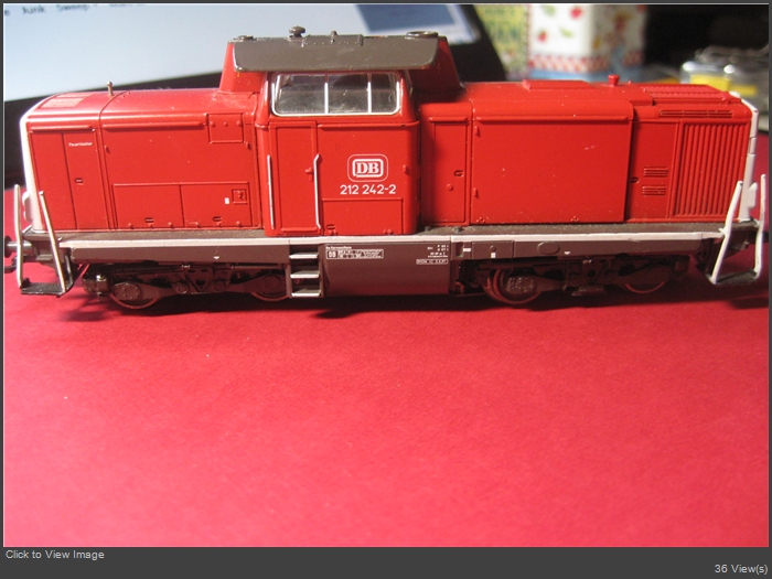

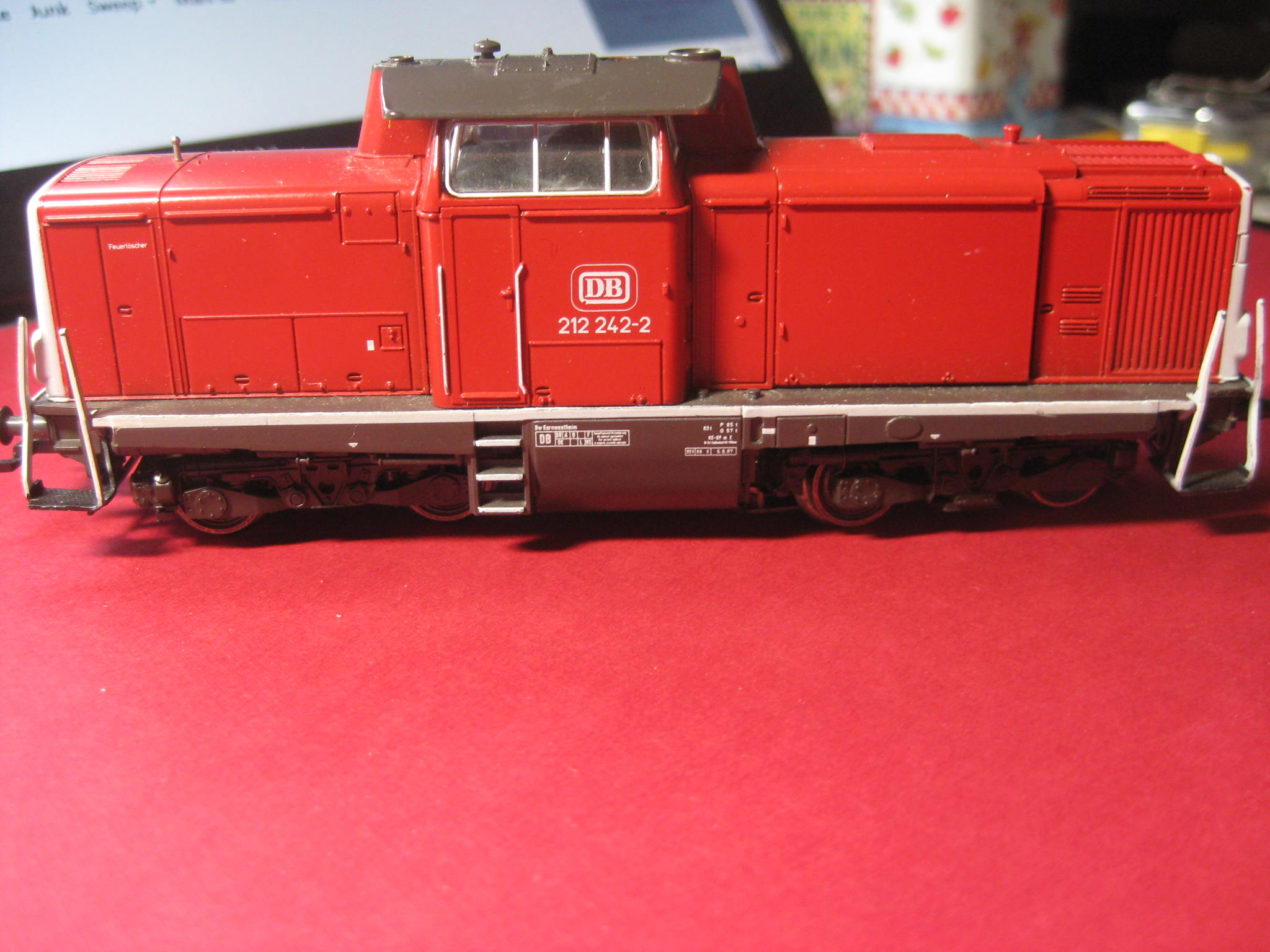

I have two Marklin locomotives, and both lights will work both forward and reverse, but will not run. I am new to AC Marklin and am trying to sell collection for a client. Any Help here? Here is a photo of one of the Locomotives.
gerrybikeman attached the following image(s):
Offline Ian555
#2 Posted : 17 December 2012 17:17:03(UTC)
Ian555
Joined: 04/06/2009(UTC)
Posts: 20,293
Hi gerrybikeman,
Welcome to the forum. ThumpUp
Ian.
#3 Posted : 17 December 2012 17:27:27(UTC)
Welcome to the forum....but it would be nice if you'd introduce yourself ....don't you think?
Simple answer to your question: the inversion relay has a contact on top.
In 99% of the cases that contact doesn't close....all you need to is to adjust the pressure so that it closes again when the inversion relay is not activated.
However if you are not familiar with the procedure, it is easy to ruin the relay altogether, so take the time to understand how it works first.

#12 Posted : 18 December 2012 03:11:31(UTC)
Posts: 3,999
We'd really need to know a little more about the two loco's in order to help you and for anyone wanting to make an offer.
ie; Do you know if either of them have a Digital Decoder fitted?
The "81 010" is 'probably' a Marklin 3032 with normal 'analogue' drive, but could easily have had a Decoder fitted.
The "212 242-2" could be either a 3347, or 3647, (33xx indicates electronic reverse, 36xx is the Digital version).
We are assuming you are using at least a Marklin AC controller to do the testing?
As others have mentioned, you'll save us all a lot of time and speculation by popping the housing off and uploading photo's of the inside.
Housing should be easy to remove, often a single screw in the top, in the Dome on the Cl 81, and possibly in the Cab roof on the 212.
They may also have a serial number sticker underneath, the prefix in front of the number can sometimes help as well.
Just to double check, BOTH loco's have the lights at both ends illuminated, but no movement? - is there any hum from the motor?, do you know when they were last run?
It is possible the drive train is simply seized with dried lubricant, or they may have Digital (or Delta) decoders fitted but been wired so that the lights are always on. In this case, you'd really need a Digital controller to run them - the address can be figured from the dip-switches on the decoder, if fitted. But, they should still run at about 2/3rd speed even on a pure AC signal from a standard Marklin controller, (with blue or white plastic case but recommend NOT from a metal-case blue controller, they are very old).
The Loco reverse is done by turning the red control knob back past zero which generates a higher voltage 'pulse' to activate the reverse relay or circuit.
A Cl. 212 pretty much same as you have sold a few days ago on Ebay for $45.00 if that gives you an indication.

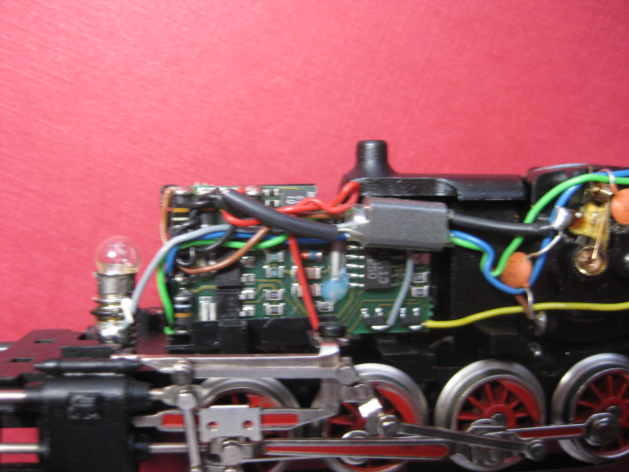

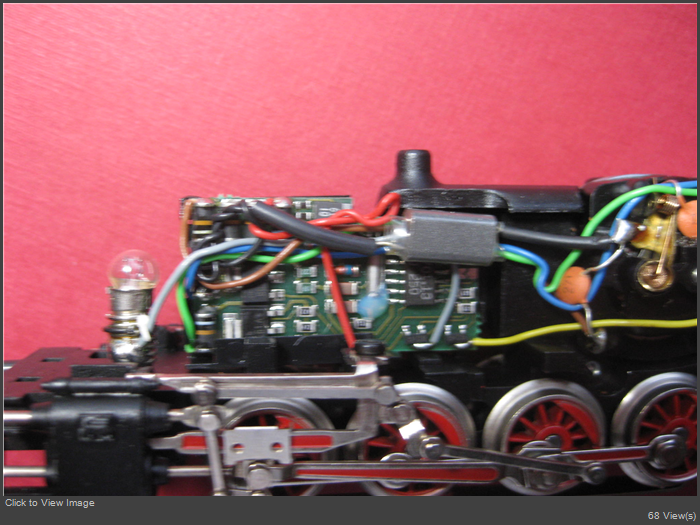

IS THIS DIGITAL DECODER EQUIPPED? THANKS FOR ALL THE GREAT REPLIES. GETTING TO THINK
I WANT TO BUY A FEW OF THE EQUIPMENT MYSELF AND ENJOY IT?
#17 Posted : 20 December 2012 00:14:29(UTC)
Hi geery.
This is a loco equipped with a Delta decoder.
Probably from a starter set.
Delta is actually the same as digital, except for the number of possible adresses and limited function control, if any.
So, no wonder it doesn't work in analof: you'd first have to set all teh addresses to "0".
