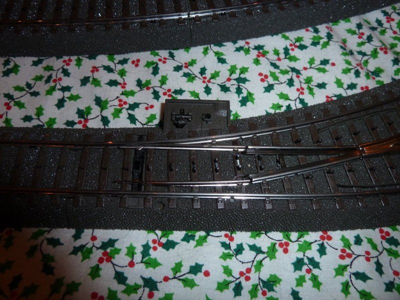

I have setup a new layout with some turnouts from the main circle that runs into a smaller circle. One of my cars is a lighted Christmas car, and when it crosses over each of the turnouts it sparks. Is this a problem? Any suggestions on how to fix. Thanks.

Originally Posted by: wsscott Go to Quoted Post
Is this a problem?
Probably the centre rail pickup touches the rail (or the frog maybe). Which type of track? Which type of turnouts?
Make sure the pickup shoe is straight horizontally and vertically and parallel to the rails on straight track. Maybe it helps to reduce the pressure of the springs if it already is straight.
Hi WS,
If you are using C track, I get this same spark effect on a few pieces of long wheel-base rolling stock.
In my case, it is caused by the back of one of the wheels touching one of the centre pukos (the centre pick-up stud). The particular puko is one that is closest to the rail. I can often solve this problem, by using a needle file.
I carefully file the side of the puko so it is not touching the back of the wheel as it goes around the curve. I find that a few tenths of a mm filing will do the trick.
#5 Posted : 10 December 2012 12:09:40(UTC)
Posts: 14,881
make sure the gauge is correct, compare it with another carriage and see how far in the wheels are on the axle.

I"m using C-track. It only does it with this one car. The Christmas car has a pickup shoe and is lighted on the inside. You can remove the "body" of the car to access the inside stuff. The track is just a temporary setup around the tree and its on a tree skirt. The track seems to be connected ok, but it seems to spark at the transition where the track splits into the 2 directions. I guess I just don't want to do any damage to the car or its pickup shoe, the rail or somehow the engine or power supply. I didn't know if this sparking would affect any of those points.
#7 Posted : 11 December 2012 16:28:19(UTC)
Posts: 15,474
Sparking is not a good sign, but can often be ignored if no other problems occur.
Curved turnouts, sleek turnouts, or standard turnouts?
Most trouble of this kind comes from curved turnouts, often the slider makes contact with the frog.
Does it spark both ways (left or right)? Maybe it helps to turn the car 180°.
Do you have left and right turnouts of this type? Does it spark on both types?

#9 Posted : 11 December 2012 18:21:48(UTC)
Posts: 9,300
I guess it´s wheels and mfx that causes problem.
I did had this problem with glaskasten which did sparks on the wheels over turnout when i did had first generation of Marklins new system.

I think its probably because the car is light in weight and lifts up after it passes through the turnout. I'm trying to figure out how to attach to photos to this reply but not having success. Some help would be appreciated. You'll see the undercarriage of the car, which seems normal to me. Also the turnout. I have 4 turnouts in both directions and this car sparks on each of them regardless of direction of travel. You can see that right after the switch ends that controls the direction of travel, there is a dark piece of plastic in the center of the track on each turnout. It seems a bit higher than the rails. I think when the car passes over it, the car is lifted slightly and this causes the spark. I don't have this issue with the loco. I guess ultimately my question is whether or not this is damaging to anything in the layout? I'm not afraid of a fire starting, but don't want to damage the loco, the track, the car, or the power supply. Thanks for all your input.

I don't think anything is wrong with your turnout. Normally this sort of thing is more of a result of slider configuration. If you remove the locomotive from the track, set the transformer to an average speed (ignore transformer setting if digital), and slide the wagon by hand over the track, do you get the same result (sparks)? Does it happen in both directions? Does it make any unusual noise as it passes over the middle rail pukos? I can't say from the top of the slider in the picture, but I wonder if it's just out of adjustment a bit. You could remove and reattach it, just to make sure the seating is ok.

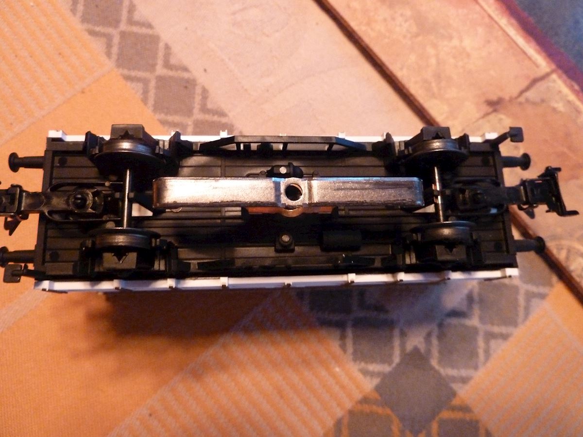

Here are the photos shrunken.

Scott, it clearly demonstrates, when you look at the slider, the wearing line is not centred, so your slider must be off centre buy correcting it you will find no more sparks.
As I've mentioned before, you have to thoroughly inspect the slider.
I can assure you it has nothing to do with the tunrout and Ia dvise you to take the slider off and inspect it. you can clearly see on one side (right hand) the slider had some arcing whereas the other side is clean.
Weight sometimes is an issue but very rarely if there is too much tension on the slider and yes the weight is minimal, it could occur.
you only can compare the sliders from carriage to loco but this will not fix the problem, everything else you possess, e.g. loos and other carriages do not show this sympton so we can with some confident, eliminate the turnout. Have you checked the gauge on this axle ? have you inspected the slider?

I agree with John. It looks like the slider is off center. I think what happened is that the slider got bent sideways. This is a common problem with packaging when you push your loks and rolling stock sideways into the package and forget to compress the slider.
I know that packaging of these cars are different. A good bend in the other direction would help.
Also, although it is rare with Marklin products, you should check the gauge of the wheels, perhaps they are narrow and cause the car to shift too much. Probably not enough to derail but enough for the slider to be too much to one side.
Looking at the picture, it also is not quite as parallel either. These little things, on their own, would not be much of an issue but each will contribute to the slider offset problem.
To check for wheel set gauge, pop the wheels out and set them on the track. There should be little side to side motion. Also compare to a good lok as the lok would have more detailed quality control. If the gauge is out, twist and pull wheel to gauge. Keep in mind that the distance of wheel to axel point should be as equal as possible.
To verify slider performance, swap slider with one that is a good performer. If issue is resolved, compare the 2 sliders and adjust if necessary. If this is too much, replace the slider.

There does appear to be some slop in the wheels, such that if the car is pulling to the outside as it would with centrifugal force being applied, it results in the wear streak on the slider to line up with the pukes. So it seems setting the gauge might be what's needed. How do I adjust the wheels to widen the gauge. I dont want to break them off!! Thanks.

To adjust the wheel gauge, take the wheel set out of the truck (bogie).
The wheel that you do not what to move, grab the wheel and the axel and hold tight.
The wheel that you do want to move, grab and twist. While twisting, pull a little to get it to move to place. If we just pull, it would slip right off so that is why you want to get the wheel moving while twisting and while twisting, you can make minute sideways shifts.
Harald

The slider obvious has some arcing so I don't know why you are not persuing these 2 parts (slider and the gauge of the wheels).
Harald has mentioned why a slider can be bent accidently and sometimes the 4 leaves from the slider one of them may seperate from the slider baseplate but sofar I have had no acknoledgement what you have done or haven't done,

I appreciate everyone's time, input and patience with this issue. I finally had time and took the wheels off the car this morning and compared the gauge with the loco's gauge and they appear to be the same with no need for adjustment. They just line up with each other. I also took the loco off the track, and just moved the lighted car by hand, and as the car comes into the turnout it rises up a bit going through the 2 turnout rails regardless of the direction the turnout is set to, and then as it comes out of the twin rails in the turnout the spark occurs. It doesn't occur if I'm pushing the car by hand, but only if the loco is pulling it. It does this for each of the turnouts, regardless of direction. I also turned the car around to see if its direction mattered, but it doesn't. The slider is solder wired to the lighting board inside the car, so its not as easily replaceable as with other sliders. I tried to lightly bend it, and it seems to be more centered over the puks, but hasn't solved the problem. And as I said it only does the sparking at the turnouts and after the car has passed through the turnout. Everywhere else in the layout it doesn't spark. I still think it has something to do with the weight of the car since when it has light pressure from my hand moving the car through the turnout it doesn't spark presumably because it maintains its contact with the puks, and the only place in the layout where the cars rises up is when it goes through the turnout. So much for my analysis.

Looking at the photo of your switch track, I noticed that the first pin on the outer side of the tracks seems to have been a little bent/twisted.
As suggested by some other members, the wear marks on the slider seem to suggest uneven wear.
