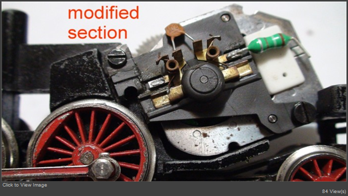

John,
found a picture of the conversion, this may help you identifying the spot where to cut the brushplate
regards.,

John,
I am in the process of converting an old 3048 locomotive to digital.
Thank you for the picture, following my question to you.
I can see what you mean.
Now just waiting for my conversion kit to arrive.
In the meantime, I checked out the wheels and the gears of the locomotive to see how she is going to run.
To find that 1 of the gear wheels need to be replaced.
The drive armature slips a little on the top wheel.
I need to order 20515 for the loco to run smoothly.
Regards,BigGrin
