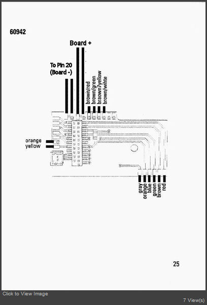

After a lengthy wait for a 60942 decoder, work to upgrade my 3652/3656 Croc is now underway and progressing well. However, I have hit a snag and as usual I am looking for some advice.
My plan was to replace the c90 decoder and filament lighting in the loco with a 60942 decoder, and LED lighting fed from a 606218 board, making the head and tail lamps on my Croc operate like those on the more modern 39560 version, in true Swiss style. I have been following a couple of threads to find out what to do, the one on this board being < https://www.marklin-users.net/fo...--29510-Starter-Set.aspx > which has been invaluable.
With the new decoder in place the loco registered itself on my CS2 with no problems and it motors beautifully. So far as the lights are concerned, I can get the 3 white front and 1 red tail light to work in both directions of movement, but I cannot get the 1 red to change to 1 white in SBB fashion. I have selected F1 as the function key to do this and followed the instructions in the threads slavishly, but when I press F1, rather than the red tail light changing to white, all that happens is that all the lights start to flicker rapidly. It does not matter which way round the loco is travelling, the effect is the same. There is no flicker at all when F1 is not pressed so I do not think that this flicker is a case of the track voltage getting on to the light circuits.
Both of the threads that I have used are a few years old and used 6090x decoders, so there is reference to a violet wire from the decoder to the circuit board, My 60942 has no violet wires and I have used one of the decoder ground (orange) wires instead, but I wonder if this is the problem.
Any advice on what may be causing these effects will as usual be much appreciated.

#20 Posted : 01 January 2013 23:33:52(UTC)
Posts: 15,474
This could be the problem: violet would be minus, but orange is plus.
The flashing lights could indicate a short circuit/decoder overload situation.
To get a replacement for violet (minus), there are several potential solutions.
  • Pin 20 from the decoder/interface PCB
  • two diodes wired correctly towards slider and loco frame respectively
  • an unused function output that is always active
I have seen Märklin locos where they used permanently activated function outputs to provide "minus" to the noise sound module.

#22 Posted : 02 January 2013 09:29:12(UTC)
Posts: 15,474
The Pin 20 route seems most elegant but how do I identify it?
There are 22 pin positions, pin 11 is missing (but it is counted).
On the outside you have 1 through 11, on the other side 22 through 12, with pin 22 next to pin 1.
On page 25 of the decoder manual is a drawing of the PCB. Pin 1 is top left, pin 22 right beside it, pin 20 two steps downwards. Maybe it is connected with an unused (undocumented) solder pad at the edge of the board.
It's the pin between brown and green.

Thanks for the update Tom. I have done some checks on the decoder board and can confirm that Pin 20 is taken to 2 unused pads on the top of the decoder. I have updated a drawing I attached to a different post to reflect this, which may be of use to others.
I have removed the orange wire from where the violet wire should have been and replaced it with a connection to decoder Pin 20 but, while the flickering has stopped, pressing the F1 key now has no effect at all.
Apart from registering the loco and changing the icon for F1, I have done nothing to the CS2 for this loco. Do I need to change anything there?
Further help would be gratefully appreciated.
Robert Davies attached the following image(s):
Robert

#24 Posted : 02 January 2013 17:59:12(UTC)
Posts: 15,474
F1 should switch AUX1 (Ausgang 1) by default - you can verify this in the function mapping of the CS2.
AUX1 is the brown/red wire (just to make sure that's the wire you used).
If AUX1 should be damaged, you can still try AUX2 through AUX4. Or test it manually with Pin 20 (active function outputs just make a connection to minus).
Maybe the light board got damaged (with orange instead of violet).
