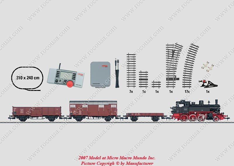

I've just joined the forum because I have some Marklin Gauge 1 kit and I would really appreciate a little advice.
In HO I have two rail DCC using Lenz equipment which works really well but I seem to be having some problems with some Marklin Locos and a Mobile Station ( the first version No 60652 which came in a bargain price start set with a Br89 ).
The two locos in question are 54561 ( Br18.478 ) and 54562 ( Bayern S3/6) They are identical mechanically and, I imagine electronically and are fitted with 519093 decoders and sound ( not MFX ). I've had them as static display models for a long time but I'm now looking to semi retire and build a garden railway.
From the factory they are both set at address 18 so I knew I needed to change the address on one in order to program both into the Mobile Station at the same time. Selecting the first one from the database, the right loco name comes up and shows address 18. It moves, the lights work as does inertia but the sound doesn't. Tried the second loco, same result.
I then followed the instructions for the mobile station carefully and tried to reprogram the S3/6 to 36. The Mobile station then correctly showed it as address 36 but changing the 8 switch dipswitch panel to 1 3 6 & 8 ON made no difference : It still worked only on 18 and no sound !
Repeated the exercise with 54561 but the same result.
Irrespective of the 8 dip switch settings, the locos move only when the Mobile Station is set on address 18. With the dip switches also set for 18, the brake block symbol appears as does smoke and the whistle. Inertia is working as are the lights and both can be switched off but although the symbol changes when pressing the whistle button, there is no sound.
Sound is working fine on a T3 and Br89 so it's not the mobile station.
In the tenders both have an upper and lower circuit board, the lower one has a 10 dip switch panel and a slide switch. I haven't moved any of the 10 switches ( I assume this changes sound settings as everywhere I look including the Mobile Centre manual says there are 8 dipswitches to set the addresses ). The slide switch seems to do nothing.
Can anyone tell me what the settings should be on the 10 dip switch panel ? I can't find it anywhere on the net.
I don't have any trouble with a much more complicated Lenz setup but am I doing something really stupid with the Marklin ?
Thanks in advance !

Yes, it came in a start set with a Gauge 1 Br98 tank loco, two wagons and track.
The Br 18s both have only one motor so they work fine with it.
I doubt whether it would run more than two locos - or three at the very most.

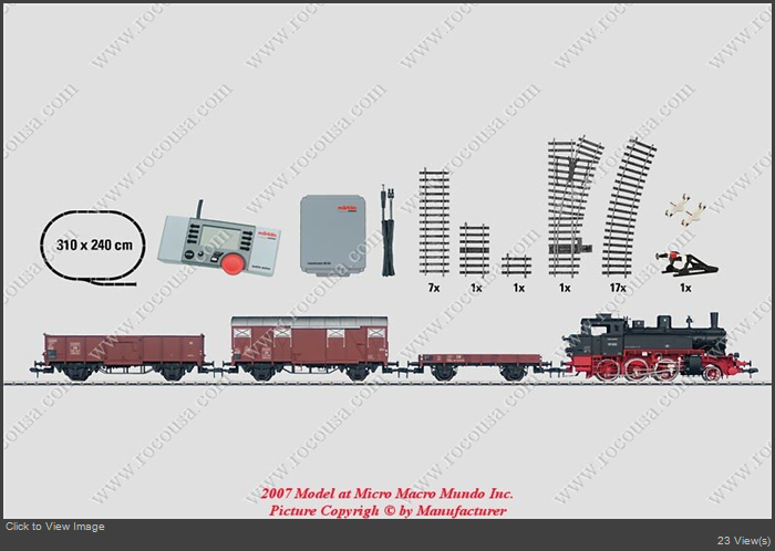

In an earlier post I did say that I bought a Gauge 1 start set which included the Mobile Station so it has to be a version built for the larger locomotives.
I haven't previously looked closely at it but I see that the transformer is rated at 3.75A ( 60VA ). Naturally it's much heavier than the HO version.
It certainly has enough power to move both Br 18s which are 4-6-2 express locomotives and the 2-6-0 Br89 from the set at the same time.
The set is number 55036 "Freight Train Digital Starter Set" and I've added a picture of the contents. It was very good value : The loco has full MFX sound and has operating couplings both ends, three goods wagons and an oval of track complete with a siding and buffers.
Two friends and I bought three sets between us and obtained a very good deal : Each cost us around €750 all in, I think. But this was some years ago !

Ah, OK, sorry for the mistake. I had wondered whether you had got the 55035 starter set with MS2, since you mentioned you had Br89, which I thought 55035 included. 55035 actually has a Br80, and the loco in your set has a Br91.
However, my comments about low power still stand. The MS1 in your starter set has a maximum output of 1.9 amps. The fact that you also have a 60va transformer makes absolutely no difference to the final output of the MS1, as the MS1 is limited to 1.9 amps. Feeding it with a larger transformer will not make any difference. It just means that the transformer will not run out of gas! Marklin included this controller in cheaper 1 Gauge starter sets to keep costs down, but that does not mean it is intended to or will power larger 1 Gauge locos.
I would try and see if you can find someone with a Marklin CS1/CS2 or ESU Ecos that you could borrow to try for a few days just to be sure that power is not an issue. Either that or get hold of a MS2 with 60112 booster (your 60va transformer will be great for this). Maybe your local dealer could help you out. 1 Gauge locos are notorious for using up power, which is why our Marklin club here in NZ uses 8 amp boosters on our club's 1 Gauge layout.
