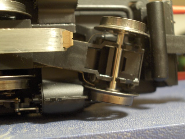

Hi Kristof,
Hoping the new traction tyres will resolve your problem.
By the way, I have the 36742 french version of this loco, and I had at first a trouble with it:
The front small wheels axle were not running.
Because of the too much pressure of small current feeding wires behind the wheels,
it was acting as brakes.
I've reduced the pressure of these wires by bending them a bit and it was OK !
Joël

Hello Joel,
Thanks for the reply. I hope in time it will solve the issue too. What you write about, I have noticed too, especially in curves... Where did you bend them, because they still need to pickup the current.

Originally Posted by: Artologic Go to Quoted Post
Hello Joel,
Kristof
Hi Kristof,
I bended gently the wires with pliers enough for there's only one wire that touch the wheels at a time.
When the left wheel touch the left wire, the right don't and so on..
I think this current feeding solution is just an inheritance of the Trix model compatibility
that must be feeded with DC current so different polarity between left ans right wheel.
I also think this current feeding system on the front wheels is useless on Märklin system.
I'll send you a pic.
Joël

So, the pic of the front wheels and the slightly bended contacts .
As you can see, the wheels are touching the wires I don't know when,
but now they run fine and I never have any problem of current feeding with this model !
Hope this helps, good luck and take care..
Joël
Offline Artologic
#37 Posted : 08 August 2012 10:03:09(UTC)
Artologic
Joined: 21/08/2010(UTC)
Posts: 502
Hey Joel,
Thanks for the tip. I ll get to it as soon as i have my toolbox moved...
Kristof
