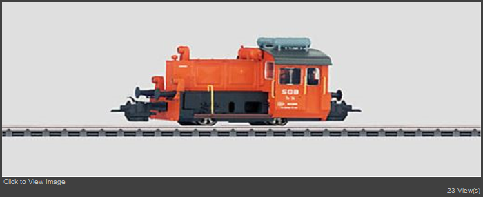

Offline jeehring
#29 Posted : 25 October 2013 16:41:04(UTC)
jeehring
Joined: 25/09/2003(UTC)
Posts: 2,786
36829....never seen it....where is it please ?
Offline BrandonVA
#30 Posted : 25 October 2013 16:47:14(UTC)
BrandonVA
Joined: 09/12/2011(UTC)
Posts: 2,533
Location: VA
See attached.
Also, adding models produced since the above list (all Digital):
36341 - BR335 (Kof) DB
37003 - BRV100.10 DB
37043 - BR80 DRG
37589 - BR58.10-12 DB
37616 - BR261(V60) DB
37695 - Class 8000 (V60) SNCB
37862 - BR86 DB (set of 2)
37895 - BR44 DB (Weathered)
37906 - BR V90 DB
37907 - BR290 (V90) DB
-Brandon
Offline jeehring
#31 Posted : 25 October 2013 17:59:03(UTC)
jeehring
Posts: 2,786
the delivery of this model always was postponed...last time they said OK for "2013"....I haven't seen it in real yet....did I miss something ?
Offline BrandonVA
#32 Posted : 25 October 2013 18:12:59(UTC)
BrandonVA
Posts: 2,533
Location: VA
Jeehring,
I misunderstood your question. It looks like right now they are claiming December 2013. I can't find any photos that are not the Marklin photo, so I think it must not exist yet. I suspect that it's probably as Tom mentioned in the other thread...shortage of telex parts.
-Brandon
Offline jeehring
#33 Posted : 25 October 2013 18:23:45(UTC)
jeehring
Posts: 2,786
I found this model interesting, and I couldn't find it even on Marklin website (sometimes Marklin's website is blocked) . I was a bit worry...I even thought my dealer forgot to show it to me....
I forgot that I could refer to updates from Steven too
Now I know.....Thank you Brandon
