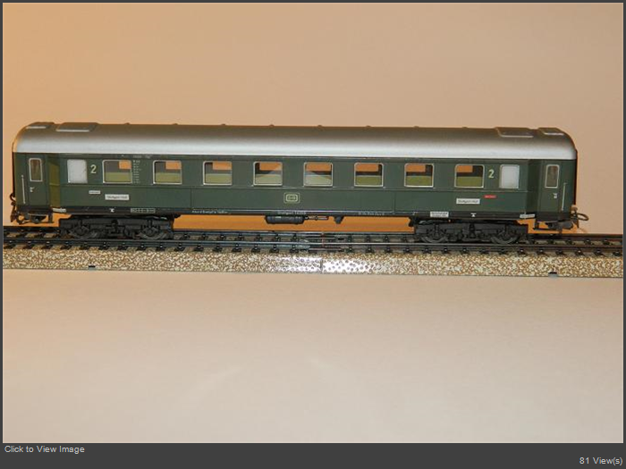

I have worked on a 4037 and a couple of 4022/52's I got off ebay - I hand sanded with very fine grit (1000 grit I think) where the bodies were crazed, and then repainted the areas with Testors Model Masters paints, 34079 plus some black, appropriately thinned and then airbrushed. I was able to get an excellent match; I'll try to post a photo tomorrow (have to borrow a camera) and let others be the judge just how close I came. . .
I have repainted roofs, including an old 3rd class thunder box, but I'm not completely satisfied with how those turned out. I sanded off the small amounts of rust down to the bare metal, and painted over that - no rust has reappeared. I'm not happy with the color of one roof, and the texture of the others (tried using Model Master steel and then clearcoated) - I must do more experimenting on this.
Fred
Ok, edited this to attach my first attempt at posting a pic - this is the 4022 whose body I mostly repainted - I masked off the stenciling. The roof is completely repainted, following a photo reference. I'll work on the picture sizing

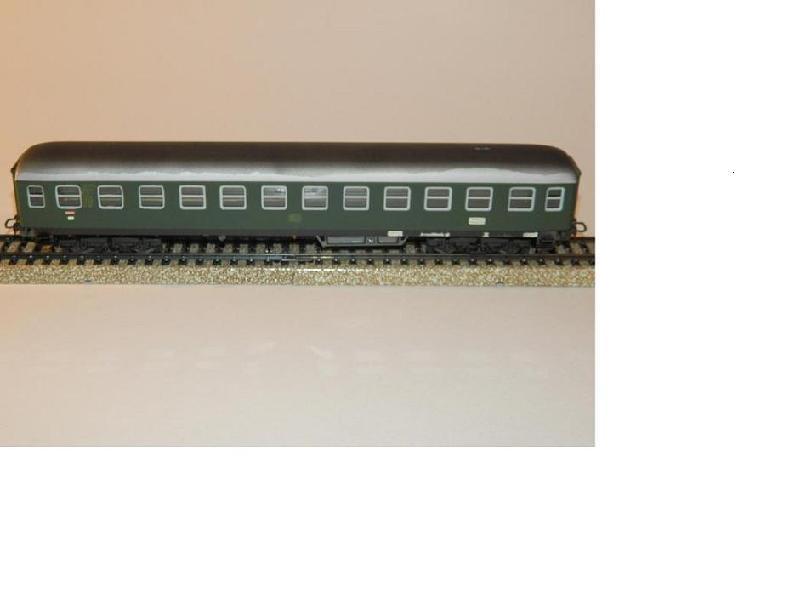

Looks my photo took above. Here's the 4037 I partially repainted - looking close under a bright light you can see the color mismatches, but I think it looks like weathering - at least that's my story. It's this roof I wasn't thrilled about on the finish - Model Master aluminum (or steel, I forget which), followed by Dullcote - the finish looks rough in person but it's actually smooth to the touch. (Actually looks pretty good in this photo.) So, at least an example of a minor restoration attempt.

nice job PhredD! I never thought about masking off the decals and painting the rest..

Phred, that is some nice work. Drool
