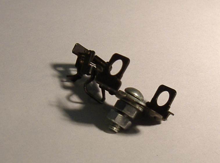

Hi Mike,
I'm not sure exactly what you mean by the pivots not being there, but I'm assuming you mean the studs they are meant to mount on, secured by a "c-clip". This being the case, you should then have two holes in the chassis where the mounts are missing from.
I was pondering this for a hopefully-simple solution for you and if it was me, I would secure the trucks with a screw each, possibly some washers if needed and a couple of nuts to lock it.
I've attached some example images of what I mean, the truck may not be identical to yours, but they are all very similar, (the side frames are removed for clarity).
I simply grabbed some 'close-enough' spare hardware (screw, nuts, washers) that I had handy, if you don't have anything like this, your local hardware or electronics/auto spares/hobby shop should have a good range to choose from. You want the screw thread diameter to be as snug a fit as possible through the truck hole so that it turns freely but with minimal slop.
So the idea is, the screw through the hole (head facing down), and if required, possibly a washer either side of the truck hole - probably depends on the size of the screw head as much as anything. Then you will also need two nuts - one for each side of the coach base hole. You may actually need three nuts to allow height/gap adjustment.
If you are lucky, the bottom nut may be about the same thickness as the original mount, which makes it easier.
Either way, you need to secure the screw so that it does not work loose, AND get the spacing between the top of the truck and the underside of the coach base correct. That part I can't photo because I don't have any coaches with the mount missing. If you only use two nuts, then as an alternative you can try to adjust the truck/frame gap with washers.
Obviously you do NOT tighten the nut against the truck, that would prevent it turning freely. Both nuts should be tightened against the base, but if the height is then wrong, that is where additional washers or different nut thickness should give you the required gap/height adjustment whilst keeping the truck stable. In fact, it does not matter if the truck can 'float' up and down the screw, it's just the height when the coach is resting on the truck that matters. If it was original, the only reason for the c-clip is to stop the truck falling off when the coach is lifted.
Bit hard to explain really but if you give it a go, I think you'll follow what I'm trying to explain. If you look at the image, the two nuts are intended for either side of the frame. The washer is the same thickness as the three 'dimples' around the truck top portion.
Others may have better suggestions than this that I have not considered, I usually go with what I'm familiar with and can do with what is on hand. Being an I.T. Tech, perhaps I have a better than average assortment of screws, bolts & springs than most but the screws shown I did actually buy from my hardware store for some other reason.

Hi Cookee
Thanks for the advise.ThumpUp
Yes the base is there and as you quite rightly say, there are just holes where the pivots should be.Woot
I had thought along similar lines - using a BA nut and bolt and using lock nuts to secure and provide the pivot.
I shall be visiting the hardware store tomorrow to see what can be found as suitable.

Wink
Well...If I had only known!RollEyes
I could have machined the two replacement pivots with the proper tolerances, that you'd simply have bolted underneath the chassis and be done with it!
Besides, it is not a 4015....but a 348/1.Wink
Let me know if you can't solve the problem with Cookee's "nuts and bolts" solution...(the spacing between bogie and chassis could be off by a few mm if you can't find a really thin nut!)

If you would take a close up picture so that I could see the type of fixtures present on the chassis I'll just make these two pivots for you...let's not futz around, and do it right the first time!

OK, it looks like that this one is not the version with a clipped-on bogie, but needs a special pivot screw.
I think it is good news, it is easier to make or provide/fabricate (I may even still have a couple of these waiting in my "bags of tricks".)
Check your private mail for more info.

....and here are the "functional equivalent" pivots bolts coming fresh from the machine shop!
Watch your (snail)mail!Smile

Ah perfect indeed - yes once a picture was up I could see that the threaded support was in the floor which makes it a whole heap easier and more professional. I was assuming that those had gone and there was literally just a hole.
As they say, a picture paints a thousand words.
