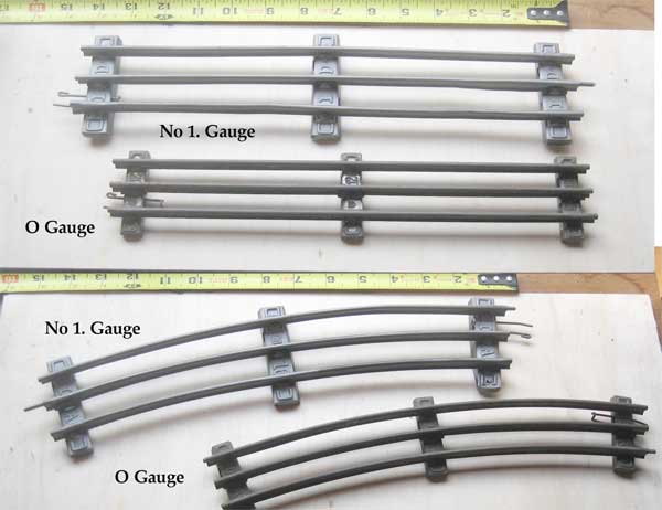

I have a Marklin CER65 12021 locomotive ( No 1 Gauge) and a Bing Spiritus Live steam, (O Gauge}. I got them in Germany in 1946 and I unpacked them last Christmas, Sense then I have had a raging interest in finding out more about them. So far I've found out that I'm financially in over my head !!1 So I am going to try to maintain what I have, and hopefully find a bargain! Recently I found some O gauge track on E Bay... Looked like a great deal! BUT, even though the track looked like mine, it was too small for my trains. my track measures 2" in width. The track I won was 1 1/2 " Both my Locomotives run on the same track, which I assumed was Prewar O gauge. I guess my track is No 1 gauge! I would like to know for sure. Anyone know??? pictures attached

Hi Jim,
Yes, you need 1-gauge track.
I assume, you have a CER 65/12921. The bold "1" means that it's a gauge "1" - loco.

My tracks do have "1" and "A" on the sleepers. I notice on the catalog, the No 1 is 2 rails, Is there a designation or name for the 3 rail/ 3 sleeper No 1 gauge track??
and does anyone know if there is a No 1 gauge track available ???

Hi Jim,
The "A" on the sleepers means that it is a curved track. Straight tracks are marked "D". The "1" or "I" means the track size one gauge. On "A" tracks you also find another number, usually "6" "8" or "12". That's the number of tracks needed for a circle.

This is the kind of information I was hoping to find!! My "A" track has a "16" on the middle sleeper! Thus, 16 tracks for circle!!??
