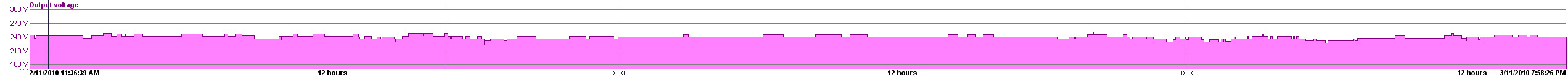

Offline Jon11
#8 Posted : 04 November 2011 07:47:17(UTC)
Jon11
Joined: 22/08/2011(UTC)
Posts: 42
Location: Sydney
I have a high quality UPS with sine wave output. The voltage is all over the place. Here is a graph over a 24 hour period.
Jon11 attached the following image(s):
Z Gauge, Black Forest layout
How dare you have clear arteries after all the cheese & wine you’ve had!
#9 Posted : 04 November 2011 08:00:05(UTC)
Views messages in topic : 15,488
Originally Posted by: Hoover007 Go to Quoted Post
It varies by as much as 10 volts!
In Germany the specification allows +/- 10 % (that makes a span of 46 V at 230 V). I wouldn't worry if the voltage varies by 10 V.
Should be no problem for devices with switch-mode power supplies.
Short voltage drops or peaks could be a problem.
