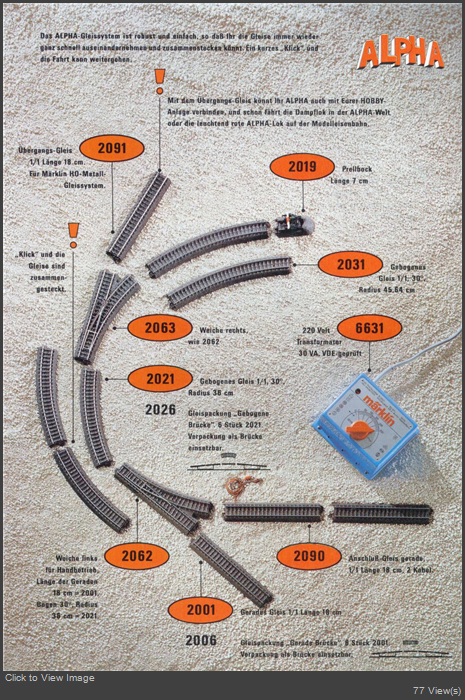

It may well be alpha track. I found this e-bay link
http://www.ebay.com/itm/Marklin...2ea8f11f15#ht_500wt_1413
Underneath it is stamped with the number 2031 so I guess it is this track
I was not aware of this product as I started with Marklin in 2000 and based on C track. Was this a predecessor?

Yes the Alpha-Track was a sort of predecessor to C-Track.
The 2031 is the "outer radius" curve and thus 456.4 mm radius. Inner radius would have been 2021, and 2001 is the straight (180 mm) piece (a few more types were available). The Alpha-Track also had a different rail-profile (I think it was slightly higer than C-Track).
The Alpha-Track was issued with the "futuristic" Alpha-line of trains could it have been in the early 90's? Not sure of exactly when, but they didn't last long. Then came C-Track with the same "style" yet different gemoetry, color and the mentioned rail-profile.

I would say "can" - but I wouldn't use it myself, nor recommend it...!
You will have to either live with the difference in height of the rail profile, or you will have to smoothen it out. And the (straight) lengths doesn't match the C-Track. And finally the 2031 do not match a C-track R2 yet will be an "exotic" radius curve.

Here's some info re the Alpha track
Melbourne
