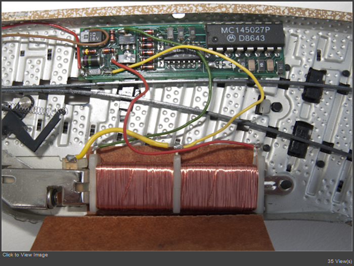

I notice that you refer to a circuit board underneath, and one of them being from a digital starter set. They haven't had decoders installed in them have they? Marklin used to make a decoder for installation on the underside of M track points. If they have then they need to be wired for digital.
Any chance of a photo of the underside?

Image attached (I hope!). I think the decoder is the small unit at top right. Viewing the underside this closely I can see that the spring looks suspect but not sure that this would entirely explain the failure to switch.

this is getting to be interesting. Is the photo from a curved turnout ? I had two of them in my origional Marklin 2602 starter set but never opened them. They worked with the digital control unit that came with the starter set on buttons 3 and 4, however they never operated when I upgraded to a 6021 control unit many years ago. The only way to operate them would have been to install a switchboard with the correct address.

These turnouts cannot be used in analogue operation! they are digital only. If you try to use them on an analogur layout you will destroy the decoder.(possibly what caused the moke on one of them).
The address on them is set by bridging some solder pads on the decoder. If they are all like this, you need to use a marklin digital controller to switch them.
I'm sure someone here on the forum will have a copy of the old marklin digital handbook that they could scan and email to you.

The turnouts you have with this circuit board in them have been retrofitted with the 6073 decoder and are digital .. .
Do not power them with conventional analogue transformers as you will most likely blow the decoder ... these require 6021+keyboard, MS or CS to operate and to do this you need to figure out what address the decoder(s) have been set to .. address on the 6073 decoder was set using the solder pads on the circuit board ...
Any that do not have these circuits but have the traditional 2 x blue wires, 1 x yellor wire are still analogue
