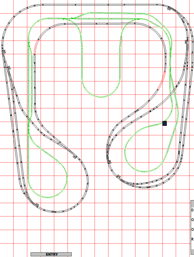

Is is possible to attach images to this forum? I have attached a copy of the layout we designed for this customer. The green track is Marklin HO.

#9 Posted : 13 June 2011 17:12:32(UTC)
Posts: 14,876
Thanks for layout picture.
One thing I would like to mention: the 2 loops on either side (black) why not add a couple curved turnouts on each loop, this will give you an independent flow of traffic for the inside and outside track and most probably more options.
Layout plan looks great.

#10 Posted : 13 June 2011 19:17:51(UTC)
daylightdon
Joined: 12/06/2011(UTC)
Posts: 12
Location: Sacramento CA
Thanks John, We may well do that down the road a bit, but for right now my customer just wants to get things going. I'm also building (Assembling), a "G" gauge railroad that will be overhead in this 14.5 X 19 foot room. It will be truly a "MULTI-GAUGE" Train room. (I WILL NOT DO "Z" Gauge!!!)
We are fairly adept at changing, re-doing, re-working, adding in more track and scenery. It's the nature of model railroading.
The (Black) track at the top will be about 5 inches above the (Green), track which is HO. The (Black) track closest to the edge of the benchwork in front of the HO will be hidden or tunneled.
I will be posting progress photos in the coming weeks and months.
