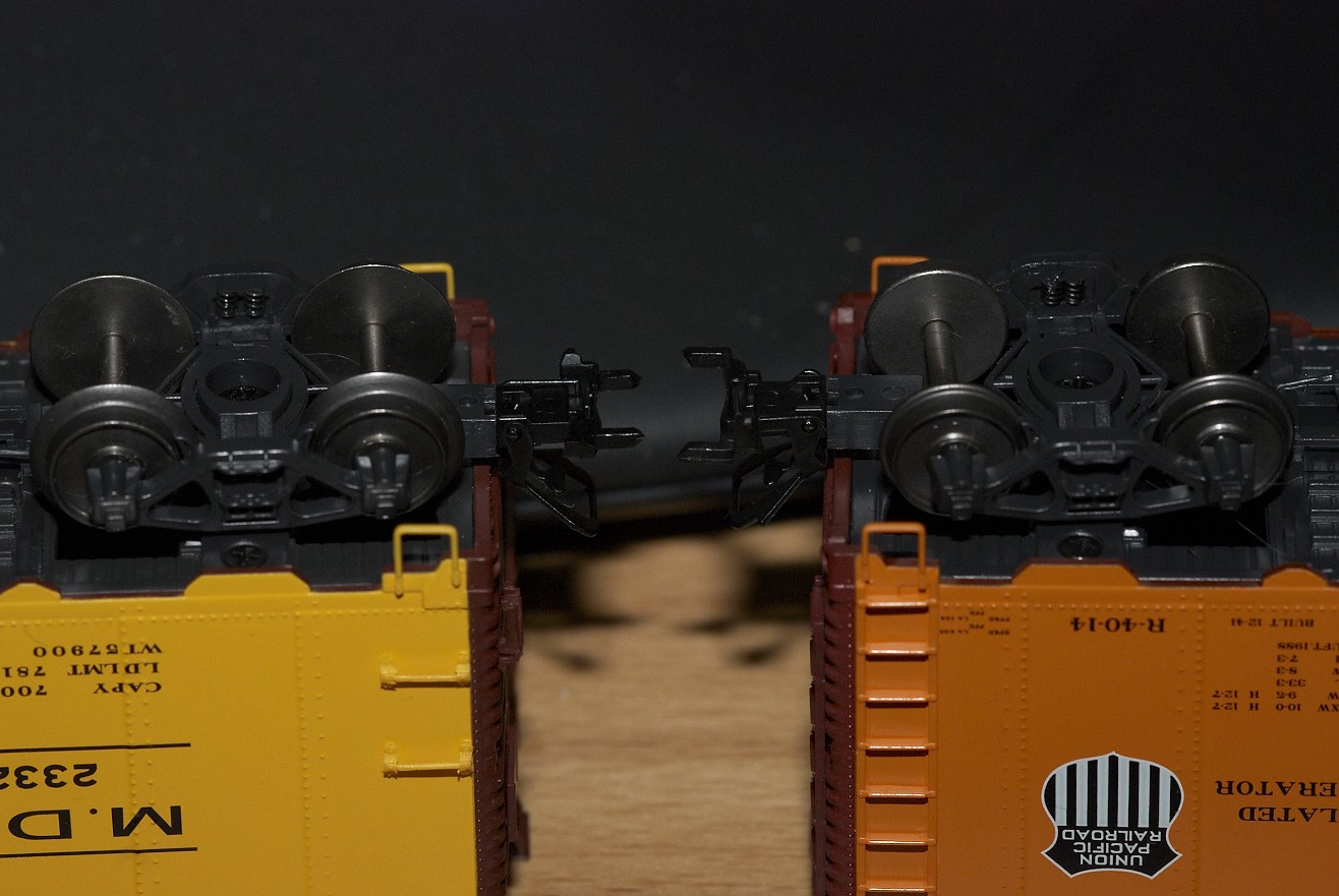

I had some issues with DC wheelsets on C-tracks. I bought the Pacific Fruit Express set (45680) which derailed almost every time when crossing the turnouts. For a newbie like me, I had to do a lot of research before I noticed the difference in the sizes of the flanges. Then I also noticed the insulation. When I pushed the boxcar manually over a turnout, I noticed that the wheel hit the centre piece of the turnout and derailed.
I think it is a bit weird that Märklin ships sets with dc-wheelsets, if they run this bad on C-tracks.
I have attached a comparison between the NYC boxcar from the US starter set and one of the PFE-boxcars.

#16 Posted : 06 June 2011 21:59:33(UTC)
Posts: 15,467
I don't think M* shipped that set with RP25 DC wheel sets. Maybe they were swapped by the dealer or the previous owner.
The catalogue lists two kinds of DC wheel sets for this car set: NEM and RP25.
NEM wheel sets should be no problem on C track.
You are correct on the wheel sets. On the box it says NEM: 320 552 and RP 25: 320 389. I googled the part numbers and found out that both are DC wheels. Though to get the right wheels, I've ordered the 320 551 wheel sets from the dealer (on which I got a nice deal). I didn't notice this on any of the other car sets I bought from the same dealer: There were large flanges on the UP Hopper set (45800), 3x Tank car set (45580) and the UP Caboose (45702).

I talked to my local store yesterday, and I understand now that the wheelsets must have been changed in this set. Because the number on the package is what you need if you are going to use it on DC-tracks. I thought it was the current wheels in the package. So yes, I have probably been had by the other store. I will contact owner again and get the whole story about this package.
Thanks for clarifying this!
