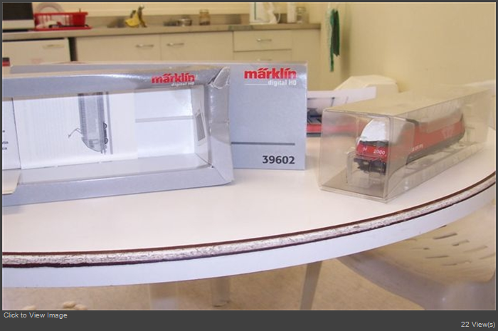

.... that we have two Marklin CS' and their Ecos.....
I share your pain! I gave up and got all 3 (although my CS1 is still at v2.0.4, and my Ecos is somewhere in the middle of the Tasman Sea, on its way from Aussie)
BTW, I have found ETS to be very good regarding packaging, no complaints at all. Even my Big Boy was well packaged. Experienced is based on having half a dozen packages sent from them. Having said that, several other forum members have said they have had package issues with ETS.
Dave,
Before I made my first purchase thru ETS I was warned by some Marklin friends in the US, whilst at EuroWest '05, that ETS packaging was below par, I'll attach some photos of it, recieved Dec '05 ( Ithink I've just worked out how). The flimsyness of the parcel was further excacerbated by it getting wet somewhere along the way, I have to add that the RE460 and the ICE train all work fine and continue to do so to this day (i hope) Mellow . The next order (which was placed with a proviso re packaging) from them was fine and over packed if anything and arrived in perfect condition. Last year I bought the Trix kits of the Hammburg Dammtor Station and they just put them in the box with no padding at all just some bubble pack at one end, also the add on kit was put in on its end so most of the parts have broken off their spru's, as have quite a few in the main kit, which makes the building of a difficult kit even more so.Cursing
Lokhop are consistently careful with their packaging I find and whilst, occasionally, the odd learkarton has had a slight krinkle, everything has allways been intact Smile
You may choose to move this discussion to a new thread ??
NZMarklinist attached the following image(s):
