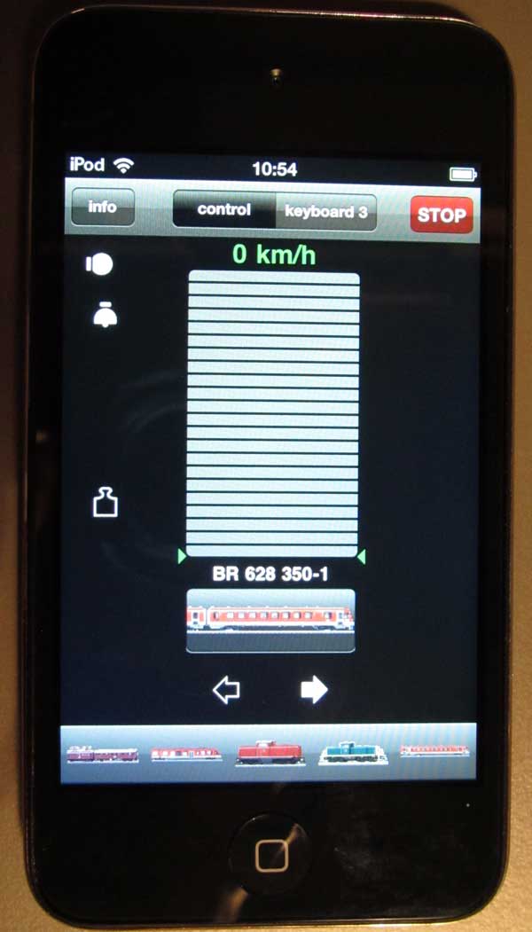

I open this topic to share experience about the new Märklin app.
I have bought this app yesterday evening and all run ok.
No istruction about it or FAQ or other on Märklin site and in the web for now.
What you need is:
1 computer with iTunes installed
1 valid account on iTunes
1 running wifi network
1 free plug on your router to connect CS2 by cable
1 iPhod touch or iPhone or iPad (see in the apple shop what model are compatible)
1 a bit of experience with computer/net/IP ecc.
The step to install:
Connect the iPod to computer with iTunes and configure it (easy)
Connect the iPod to your wifi net (easy)
Go on the App Märklin shop, buy and run the MS app (easy)
Turn on CS2 and connect to the router (easy)
Wait until the iPod MS see the CS2 (easy but I've got some gremlins problems)
Run your trains
What are gremlins?
Here the two kind available, good
and bad
One bad at the start of this video...
http://www.railtv.fr/smo...mberg/mardi/default.html
(very friendly video, no?)
Coming back to the app, now all ok, you can operate the same loco on CS2 and iPod together, all what you do on one you can see on the other. Take a loco and command is fast and easy, and the same for the keyboard.
All the loco that you have on CS2 are available on iPod with name and miniature.
Now I want to test how many MS can run simultaneously, but for this I need some friends. Smile
A video coming soon if you want.

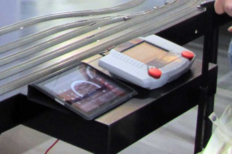

At the fair I saw the second app, not yet available, to have the draw of your layout on iPad.
Very useful compared to the screen of the CS2.
In this enlargement you see the MS app on iPad, the best for big fingers BigGrin
To use the iPod with only one hand is better the vertical position.
I'm testing this app for use it on our club layout, but I think that is the best way to enjoy all the sond functions of the new loco.
You can follow it an stay near when activate the various sounds.

today I've tested again the app on my modular layout, great experience, it works very well.
I've used the iPod by one hand, in vertical position.
It is the most fast control that I've never used, waiting time to change a loco = zero, the CS2 is a sloth.
In one hand ten loco ready to run, with their images, plus all the stored in CS, plus the keyboard pages, and in a second you can change area, very very fast.
I'm enthusiast.
For the first time I've used all the sound functions of the new locos.
You drive the loco (near it), see the station, whistle, brake, stop at the platform roof, release brake air, compressor, station announcement, wait the comnig train on the opposite direction and take the control of it. Switch the turnout, whistle, ecc.
For the test I've replaced my 6021+c80f+keyboard with the CS2. There are two circuits, one supplied by CS2 and the other by my old booster Power 3 Uhlenbrock, that run perfect connected on its socket, mxf included. There are 12 block section with brake module Viessmann, Märklin and Uhlenbrock, and 30 digital turnouts, signals and other things.
Only the CS2 trafo is insulated from the other circuits, no other change to the connections.
This iPod touch (the last model)+ Märklin app is fantastic.
And you know how I'm a Jurassic sixtytwentyoneist. BigGrin
