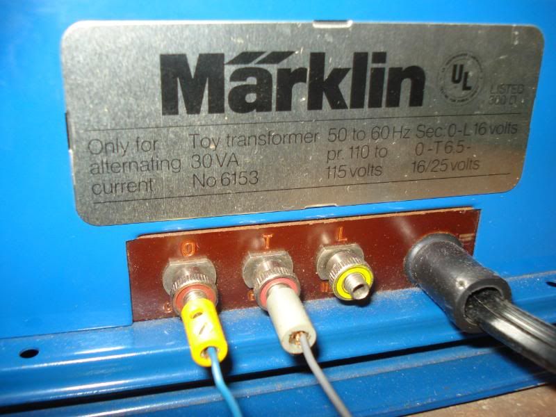

Greetings,
I am using the vintage Marklin "Blue" transformers that have the metal housing. Marklin number: 6153 30VA.
Are these things 'ok' and safe to use, or should there a problem?
Thanks in advance,
Paul

The official word is that these transformers if used in the analog mode can damage some digital decoders since the 24v reversing pulse is not regulated. Having said that, I think the primary problem is that in Europe there is (or was) a variety of primary voltages (220 - 240) and if the tranny is used in the 240 system, it will generate a reverse pulse greater that 24v and fry some decoders. In the US, this does not seem to be a problem. I have several I use primarily on my set up and test bench and do not have a problem. If you are just using the 18v output as a power source for a digital controller, it will work fine but may be a little underpowered so that you don't get the full potential out of your system. If you are not digital and running only analog loks, it should be fine.

The other issue with the blue metal transformers is that the insulation can break down over time, and therefore present an electrocution risk. Marklin had a transformer exchange program for some time, where you could exchange an older transformer for one of the newer white ones. I don't know if the exchange program is still available.

Märklin say that transformers with a nominal voltage of 110 Volts must not be used. This one is for 115 Volts.

In general: blue transformers were made for analogue locos - and a few volts more made the reversing pulse more reliable.
Blue transformers for 220 Volts would be dangerous for current digital locos even on 220 Volts, so I avoid using them.
The blue transformer on the picture is rated for 115 V while the current #6646 is rated for 120 V.
So if your local household voltage is 120 V then the loco manual tells you not to use it.

In general: some blue transformers have an insulation inside that became brittle and is no longer safe. AFAIK this should be no problem with the #6153.

As for using the 6153 and other transformers, I've used dozens (maybe hundreds) of the "old" blue transfomers with countless digital locomotives -- both in analog mode and to power digital components, and with all types of digital decoders -- and have never experienced any problems whatsoever, even when using the "over-voltage" signal to reverse digital locomotives on an analog circuit. I've occasionally measured the voltage of this reverse pulse and it can go as high as 30VAC -- still, never had any problems. As long as the cable is in good condition, and the plug looks OK (which can easily be replaced if necessary), you shouldn't have any problems.
