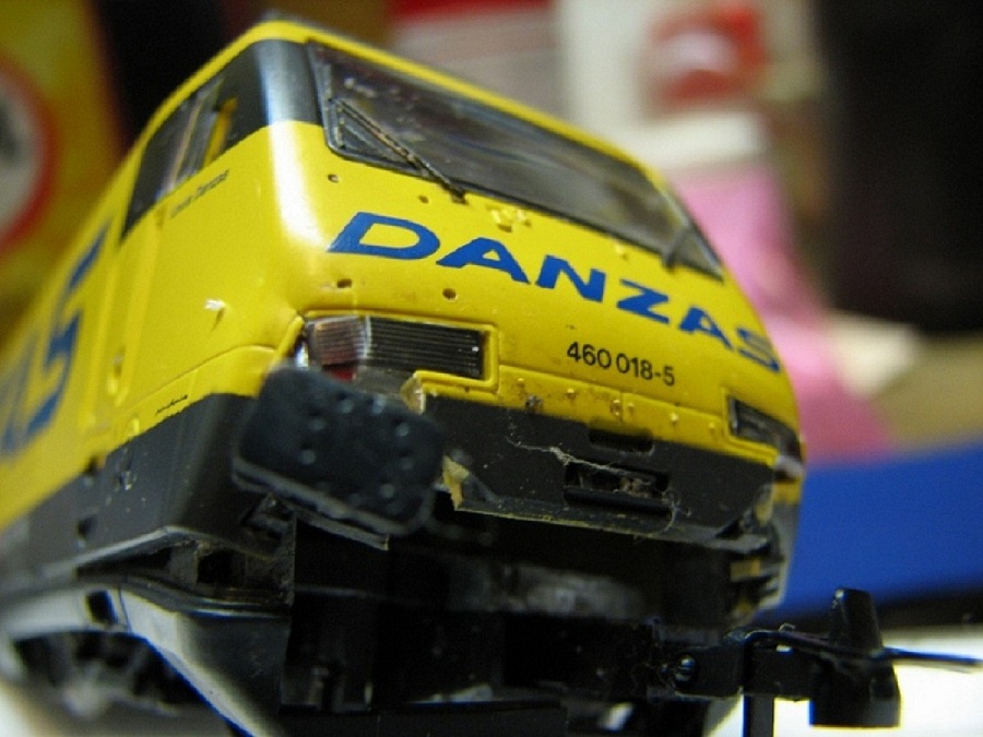

Sorry for the late reply. ROCO model with zinc corrosion is art. 43750 mod. 460.018-5 DANZAS. I have the model with zinc corrosion. Very serious problem. Sneaky Sneaky
Yelloboy
Yellowboy attached the following image(s):

Your photo shows damage to the plastic shell and skirting but does not show the metal chassis, where zinc corrosion could be seen. There has clearly been some disformation of the plastic shell, but it is hard to tell whether this is the result of internal pressure or from external impact.
If you can remove the shell and provide a photo of the metal chassis underneath as well as photos of the shell from additional angles as well as from the inside, the cause and extent of the damage can be better assessed.

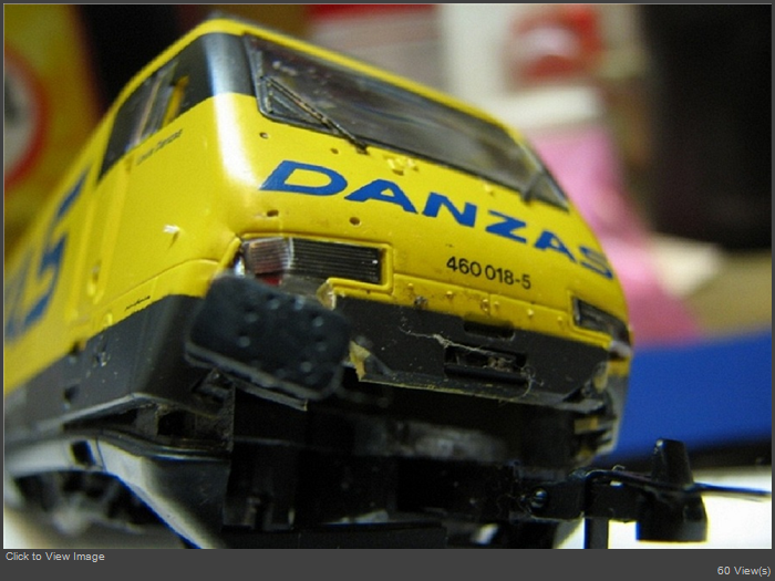

I found your post after I discovered my Roco DANZAS has also suffered this fate. As I took it out of its box, after about 10 years, I immediately noticed how tight-fitting in its box the loco was. When removed, the area around buffers at the front and back, were demolished, similar to the model in your pictures. Removing the loco body from the zinc chassis proved to be very difficult, but when I had managed this, I could see the corroded chassis had expanded and locked itself to the loco body. The parts of the chassis surrounding the bogies at each end were already broken off.
I then checked my other Roco 460s released around this time. 43750 being DANZAS. 43751 Miele, 43751 Swisspool, 43753 Milch & 43756 Ciba were all in good condition.
I have posted a few pictures of the culprit in my album named - Roco 43750 SBB 460 018-5 DANZAS
