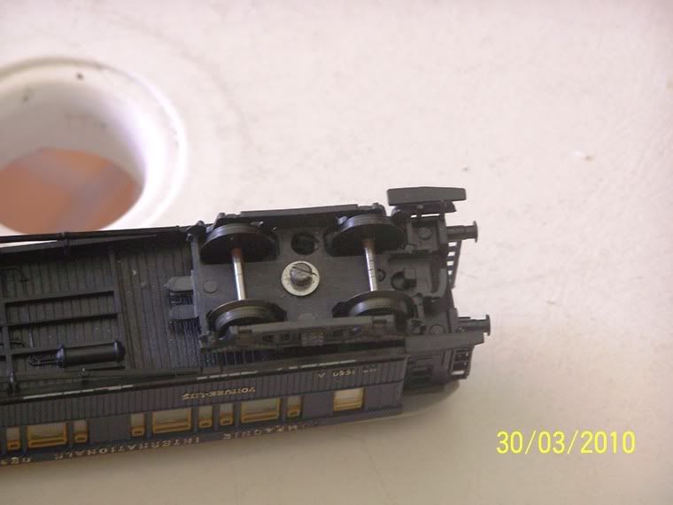

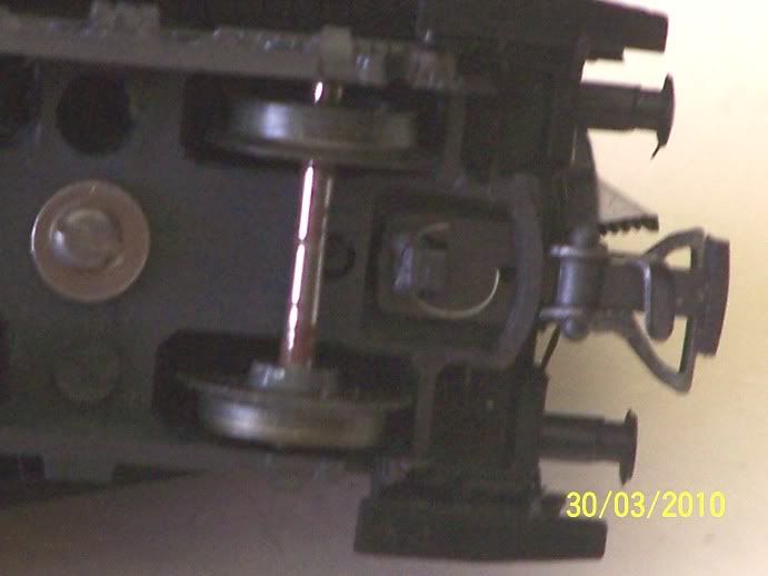

#28 Posted : 30 March 2010 08:52:29(UTC)
The liliput coaches arrived, they look good but unfortunately suffered some damage to the Bogies in the area of where the Couplings attach, broke some retaining posts and guide rails:
I hooked up two onto a loco and they ran nicely , through points and the double slip no problems.
now to find where to get some spares
Bad One
Good End
#29 Posted : 01 April 2010 02:57:57(UTC)
mike c wrote:
Nev,
there is a man named Herr Arndt who runs a hobby shop in Hof (Germany) who has a large selection of Liliput parts. the store is hofer-lokschuppen.de or lokomobile.de. The Liliput parts are listed under Fundgrube or suchen and then Liliput Ersatzteile.
I got a SBB 877 lightsteel coach set from him at a good price a while back.
lokomobile.com
Spot on, he has the complete bogies, , wheels and a few other things. Nice pricing also.
Got an order in plus spares.
ANd a big thanks to Stefan who supplied the necessary part numbers from a 1980 Liliput parts book.
Nev

Thanks Nev, unfortunately one particular car suffers from occational derailment. Probably a boggie that needs adjustment. These are quite elaborate and detailed but also quite finicky.
Btw it's Palle, but I forgive you, knowing that you are entitled to a senior's moment now and then BigGrin
#34 Posted : 01 April 2010 07:29:05(UTC)
Yep a Monster Seniors Moment
Wub Wub Crying Crying
My old ones track beautifully with the Old DC Wheels. (The ones that are complete that is)
