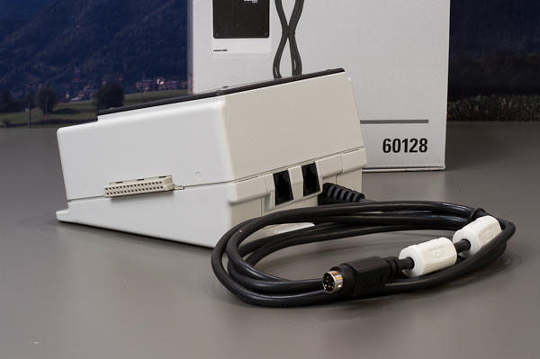

Got it today
At last the link between my loved 6021 and the new CS2.
Tested now, all perfect CoolCoolCool
Connect the box to the 6021, the cable in the 60173 socket. Turn on 6021 and next the CS2....ok, run the trains in the old system. biggrinbiggrinbiggrin
Tested control 80f and keyboard, I don't have a memory.
About the connection of the IB it's better ask to Uhlenbrock, I cannot risk so much.
Alberto

Alberto, did you plug your box into the 60173 booster, rather than the CS2 or the terminal box?
Offline Alberto Pedrini
#31 Posted : 06 January 2010 03:21:47(UTC)
Alberto Pedrini
Joined: 02/07/2004(UTC)
Posts: 1,448
Location: Italy
<br />Thanks Alberto, you da man!
No, of course
have a look to the Pag. 4 and 5
http://medienpdb.maerkli.../1/pdf/60128_betrieb.pdf
or here
http://www.marklinfan.ne...cumenti/manuale60128.pdf
Alberto

Please, scroll down the manual...
Alberto
Marklinfan Club Italia
www.marklinfan.net

Thanks Alberto. I may have misread your original answer. You said the cable goes into the 60173 socket (on the cs2), I misinterpreted that as being plugged into the 60173.
Offline Bigdaddynz
#35 Posted : 06 January 2010 09:18:23(UTC)
Posts: 18,665
[size=1" face="Verdana" id="quote]quote:Originally posted by sudibarba
<br />Do you connect a transformer to the 6021 and why?
Eric, see the architecture diagram. The answer is Yes.
<br />Does this feed additional power to the track or is it to run the 6021?
It powers the 6021. You cannot use the track feed from the 6021.
<br />Can you use a low power transformer in that case 30VA?
Most likely you can. I don't see why not!

Guys, The connector labeled as 60173 <mFX Booster> is just another 7-pin M-Bus port.
While "primarily" targeted for the booster, it can be used for the MS1
(with usual 60124 <10-7pin adapter> , just like you need for attaching to a 60125 <Terminal>)
In the same way, I expect, the 60128 <Connect 6021> to have a 7 pin plug in order to connect into a 60125 <Terminal>.
Therefore it will also plug into the 60173 <mFX Booster> port.
In summary, if you only want to use ONE of
i) mFX Booster,
ii) 3rd MS1 or
iii) a 60128
you do not need to invest in a 60125 <Terminal> for expansion.

This evening test:
CS2 + 60125 + 5 MS (3 with adapter 6104799) + 60128 + 6021 + c80f
(the 60173 socket is free)
I think this is a configuration that allow to do all what we need, seven mfx controller, two old controller and all the keyboard, memory, shuttle, draw, enclosed in the CS2.
What I have done for one hour was run 4 loco and 4 turnouts, assign loco to various control, switch, start, stop, slow, fast, assign, turn off, turn on, repeat etc.
All ok.
Every MS receive the first 5 locos found on CS2, you can manage them very fast by the touch screen, so when you are in the CS2 switchboard there are five controller visible.
Here the assing to 6021 page
This function could be useful, but why assign a "mfx loco" to the 6021? It's better control it by a MS.
The 60128 born to control the old decoder with the old controller in the old way.BigGrin
I have read also that someone have connect the loconet IR adapter and it runs.
Bye
Alberto
