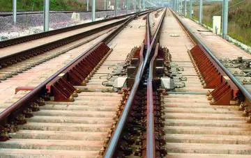

In the old days (50 years ago and more) common practice was for a train to push the blades in the point was set in the other direction. So, for sure it will not derail.
Nowadays, the situation is very different with longer and longer turnouts to accommodate high speed (some allow 200 km/h in deviation and up to 570 km/h in straight position.
These high speed points have also a special moving frog so as to avoid any damaging bumps
These very long points have a complex mechanism to move the blades from multiple points and they are high precision. So yes, for these elaborate turnouts, they will be damaged (not destroyed)
Today, this is now, out of the question. All points must be set correctly or the train is simply forbidden to move past the red signal in protection of the itinerary not set.
So the reason is security, wear of the point mechanism and the wheel flange wear.
Trains never derail by runing on a non set turnouts but can derail:
- if the blades are not fully set on one side or the other
- if the train speed does not correspond to the TO position
