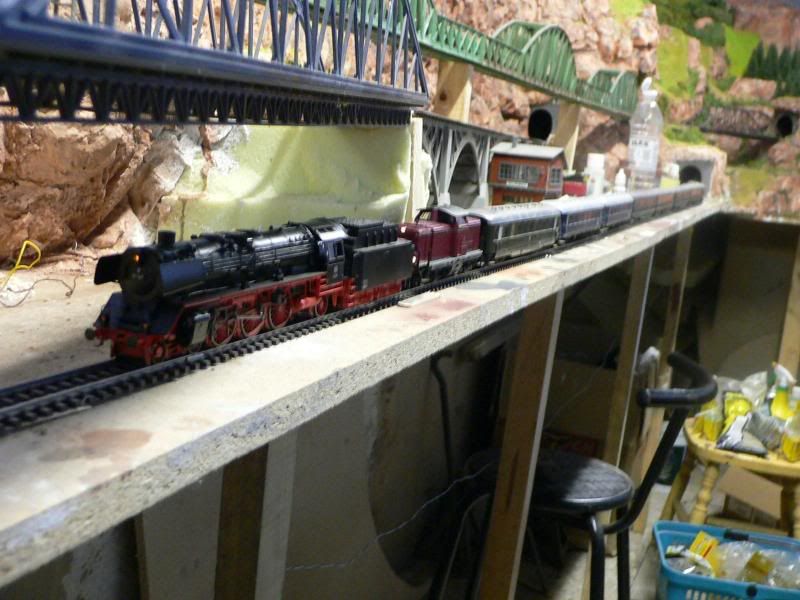

Soooooo,after a massive effort to get the speeds right,i teamed it up...with a loco that did help it in real life too.
For those of you interested in this combination...you need to set the V100 to max speed 99kmh and the BR01 to max speed 255 and min speed on the V100 to 6kmh and the BR01 to 8kmh.
Then they both run to scale speed 70kmh without spinning a wheel.
Faster than that,and the BR01 starts spinning a wheel or 2 lol.
Both acc and brake delays set to 25s on both locos.They stop perfectly.
Anyways,i hauled 9 coaches around Monsterville....6 laps...that an hour,without a single hiccup.So the BR01 stays.I will run it like this in future.

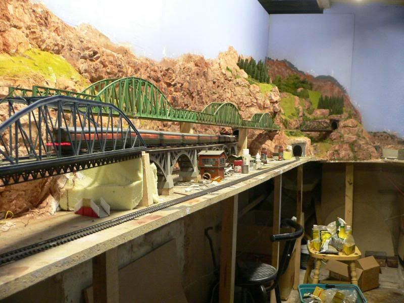

Look at that....isnt it pretty.
A silver snake.

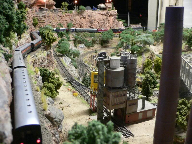

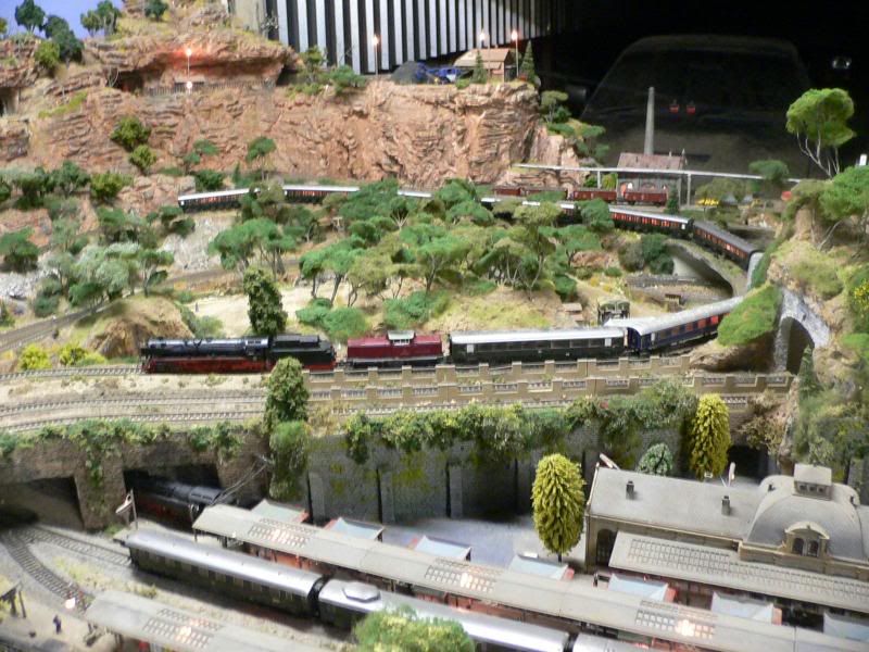

Ah,and the dreaded drama incline.When things go wrong,its normally here....but the flew over.
And the second incline.....slight wheelspin from the V100,but effortless on the straight.
