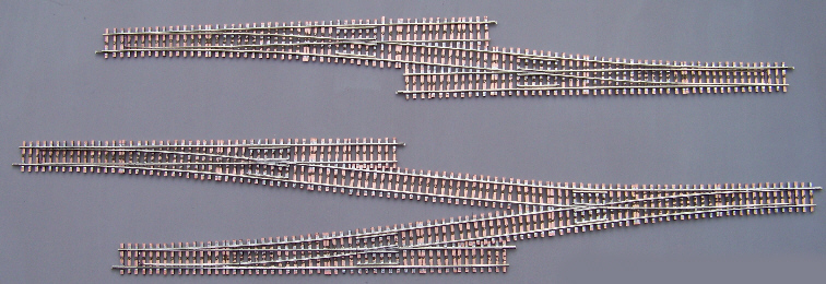

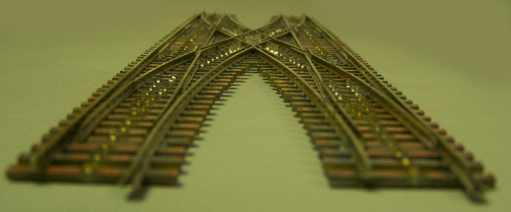

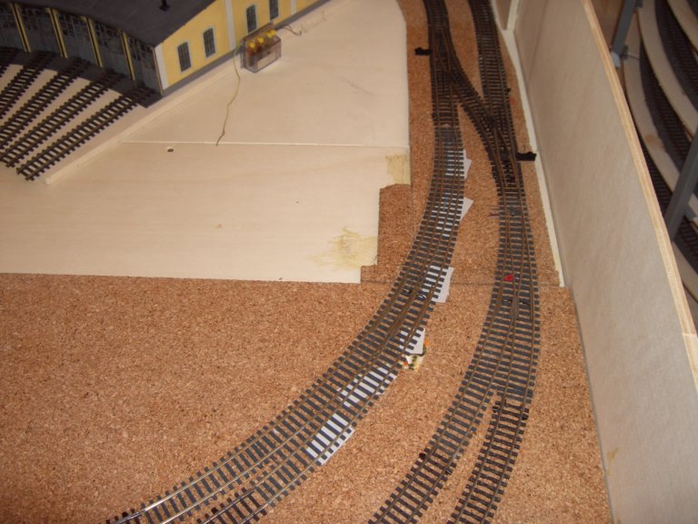

Offline weichen-walter
#10 Posted : 30 April 2009 10:58:10(UTC)
weichen-walter
Joined: 11/02/2008(UTC)
Posts: 27
Location: Mühlhofen,
Hi "applor"
Yes,these turnouts are full compatible with K-tracks.
You can desing youre own layout and than you can send it to me.
I work with Raily 3/4 - for this programm are thome tournouts of my produktion available. But I can also read layouts in Wintrack.
With these software you can design the tournouts also with Flex-trak.
One of my customer have design with this methode:
Best regards from Lake constanz
Weichen-Walter
