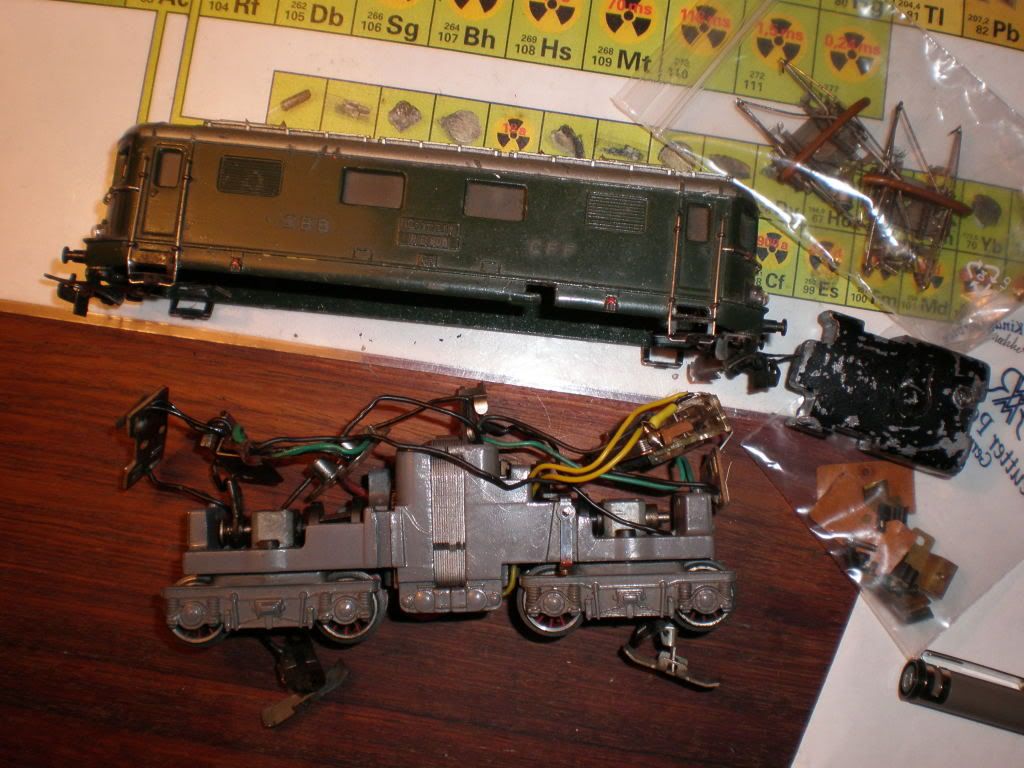

#13 Posted : 29 October 2008 19:27:32(UTC)
Bayer
Joined: 16/06/2008(UTC)
Posts: 176
Location: Helsingør, Denmark
Finally it arrived. It´s pretty much a restore-project, but that is the way i like itSmile.
I will maybe, if you guys want me to, start a new topic, where i step by step, will assembling and cleaning it.
Kind Regards,
Thor

#18 Posted : 01 November 2008 08:25:10(UTC)
Hello
I have restored a number of RE800, so no problem to guide you, if you want I can help you move step by step.
It is probably my favorite Marklin lok in my whole collection...
It is however a very difficult loco to put back together, I have to warn you!! (= patience needed)
I am willing to help you, but I would think twice before taking mine apart (again..)
The good news: from the picture it doesn't look like any important part is really missing.
The bogies are still in place, so no difficulty there. That is already a big step forward.
However you should start by checking the smooth running of the mechanism then verify the electrical integrity of the motor.
Next question: how good are you with soldering?
Let me know then we'll take it step by step from there..
Kind regards
#19 Posted : 01 November 2008 14:31:32(UTC)
One little clarification: I am ready to take the body off to show you the inside and guide you, but I don't fel ready to dismantle the mechanism, just to provide an "exploded view"
Your lok looks pretty much together, but whomever took it apart had no clue on how to put it back together.
Tell me when you are ready...(-;

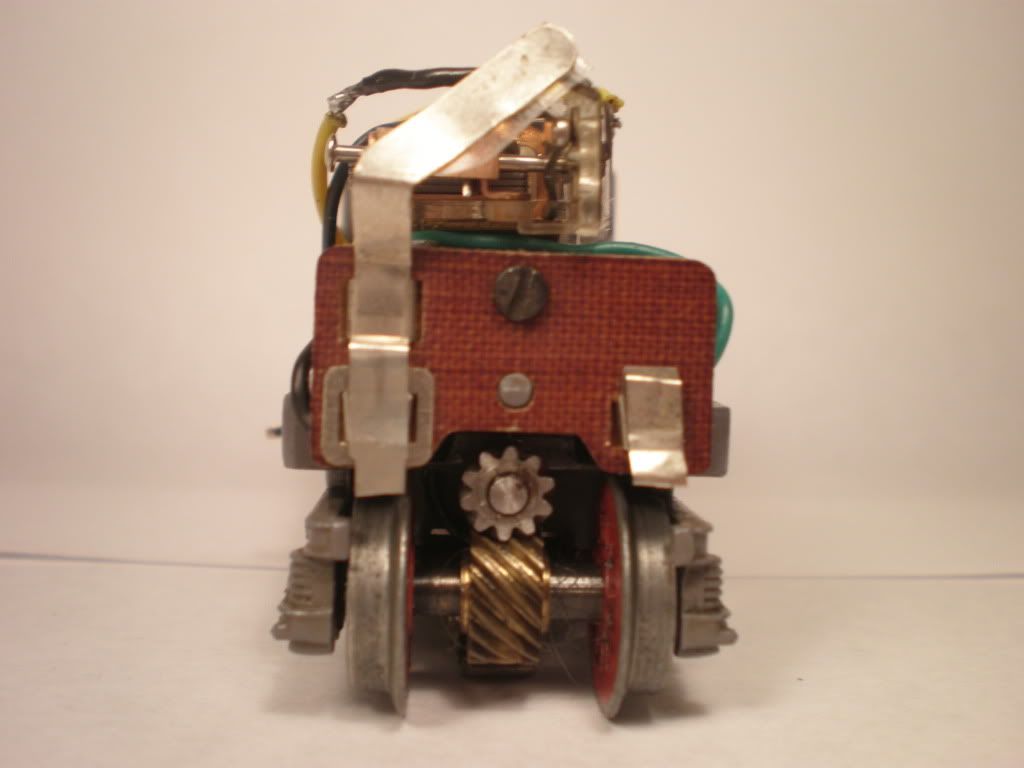

CCS800KrokHunter3
Joined: 03/04/2007(UTC)
Posts: 1,605
It may not be able to move as quickly because of the gearing. My ST 800 has many gears which have shifted over the years...just a thought. It makes a great sounding locomotive, though!
Bill

quote:Originally posted by Bayer
<br />It is running very smooth, but slow, and it seems like it can't pull that many wagons. Can anybody explain why that's so.
<font face="Verdana][size=2]
I think that's inherent to this kind of mechanism:
A lot of the motor's strength is wasted on getting that worm wheel to turn. I guess that's why Märklin abandoned this mechanism later on.
</font id="Verdana]

#30 Posted : 09 February 2009 12:16:07(UTC)
Bayer
Posts: 176
So maybe the loco will have a greater tractive power, if I disable one of the boogies. Then the loco will only pull on one boogie and all the motors strength will be concentrated there. It is worth a try.
Thor
