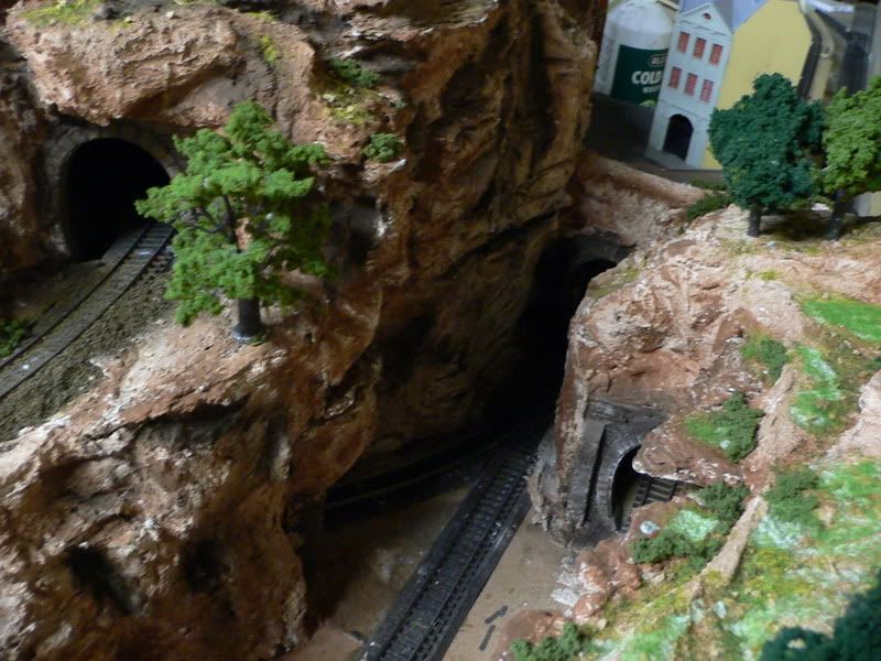

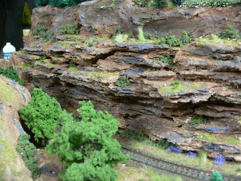

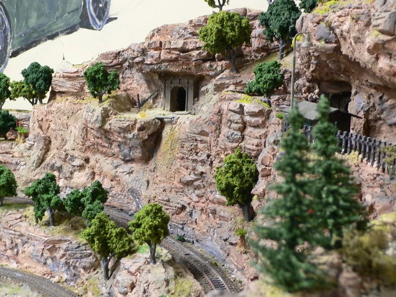

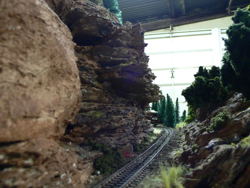

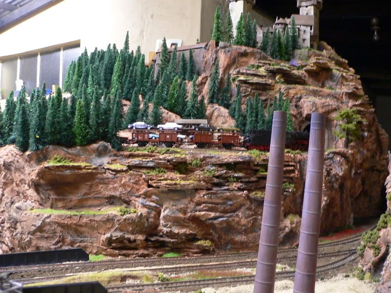

I use a finishing plaster called Rhinolight.What i do is i mix it in different thickness.The base layer being thin,almost like porridgebiggrin
I drag newspaper through it and cover the styrene base.Nice thing about this is,the styrene base shape isnt set in stone,by pulling the newspaper or folding it you can create crevices and folds.
When its dry,i mix the plaster medium thickness.You must be able to pick it up in your hand.I use a beeeeeeeeg paintbrush and "paint" this thick plaster on.Guy that taught me this,calls this prodding.Its just to texture the plaster.You twist and glide the brush and it makes the most awesome shapes.
If i want rocks,i use the plaster again.Very very thick.Almost dry pieces in it still.Now you can hold it ni your hand and shape it.Like putty.This i slap on in huge wallops,all over the place,and this i carve with a credit card into rock shapes.
I still do this here and there,but now that i discovered the broken ceiling board,it will probably just be used in small places like these...
But just check what this ceiling board does.I just took these now quickly.I LOVE it.
But obviously,if you cover the mountains,itnot neccesary for this whole sequince.It is a lot of work.I hate the carving bit.You need to file the edges smooth when its dry.It takes forever.

I havent tried anything else.I think all these products are much of a muchness.Its how you apply it that gives the different textures.
I like the newspaper method,as i can alter shapes and thicknesses at any stage.If you tell me my mountains look crap,and i believe youbiggrini can probably change all of them in a day.Just throw new newspaper.If i decided that covered mountains look better i can smooth these very quickly.
The master of mountains over here,old Ken Tuscker,never shapes anything with the newspaper.Its just a base.The thicker mixtures of plaster afterwards is where he works his magic.Ive seen him add tree bark into a solid rockface on a n-scale layout....and MAN,he is an artist.
