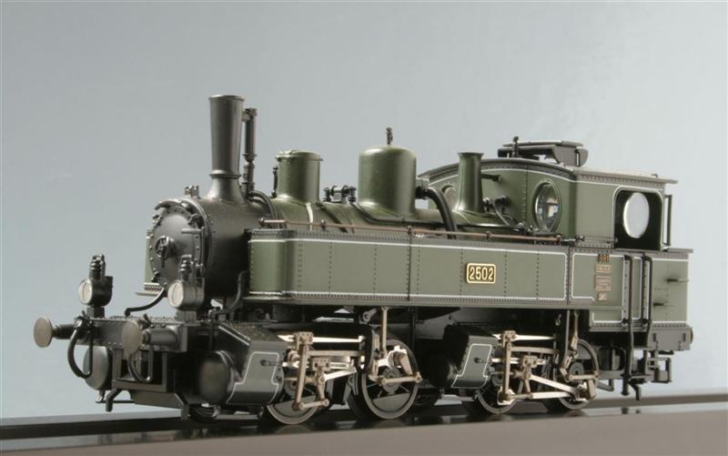

I shot Sanders model of the Roco BB II (and many other Era 1 models at the shop) some weeks ago.
At the moment I'm on vacation in Switserland, but in say a week I will add Sanders model in specific.
(See: http://www.osterthun.com...tic/0.Static~Dealer.htm)

Here's the picture, taken before Sanders assembling.

@ Osterthun: Thanks a lot! But, this is actually the model that I have not started converting yet, I'm working on the 2510 (43286) instead of this - more beautiful - 2502 (43281)...
@ all: yesterday I've conducted a first test running it, using provisional wiring, it seems to work and it negotiates several switches in a row quite well. Hopefully, I'll have time to finish the conversion next week and post some pictures.

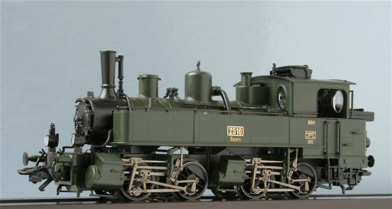

quote:Finally, a picture of the loco itself, I realise that it doesn't even look nearly as good as in Osterthuns photo, I'll just blame my mobile phone camera for it...
[size=2]OK, Sander, since you asked for it wink
Here's Sanders very own BB II 2510 taken at the shop last Saturday.
I saw it run! In two words: marvellous!!!
