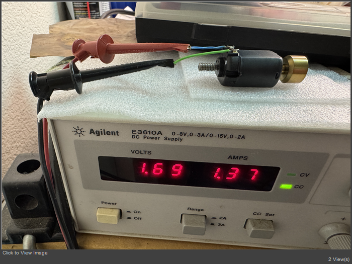

This thread was helpful! I have a new old stock TRIX 22159 which burned the decoder after minimal running life.
So, the root cause most probably is the motor. When I run it with a power source on 9 V, the voltage drops and it draws 1.37 A.
That’s more than Marklin specified maximum constant current rating 1.1 A.
The motor also runs very slowly with no torque.
Better replace it with the newer p/n.
