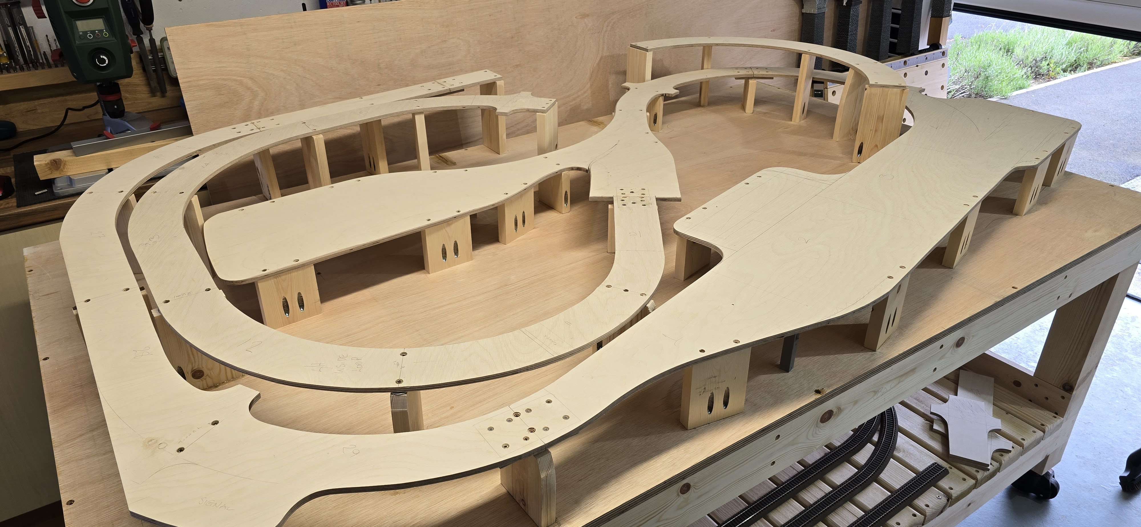

I have changed to a mobile layout due to arthritis and it’s the best thing I have done. I now have easy access to all parts of the layout. I am working in a garage with a concrete floor but I believe most hard surfaces would be suitable. The trick I found is to go for high quality castor wheels. The ones I purchased are super smooth and have a built in "jacking" system. See amazon: VEVOR Leveling Casters, Set of 4, 1100 lbs Total Load Capacity.
I believe them to be a good investment as I can move my 1.4m x 2.8m layout with one hand.
The table I built is rather sturdier than required but I use the lower section for storage.

Originally Posted by: wizardtrains Go to Quoted Post
Hi Mark
https://photos.app.goo.gl/xfqSa1zmsmPtEWx98
https://photos.app.goo.gl/MUgFiRqkgg1NMiSp7
That is sturdy enough to double as a shelter during an earthquake :)
Nice and clean work
