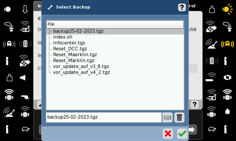

André, you probably have the files on your CS2 unless someone did a big clean
Here are the files present on mine
The file you need is Reset_Maerklin.tgz or Märklin.tgz
I have those files but I don't know how to get them past gmail (it thinks its malware)
Offline BoBaCool
#6 Posted : 18 November 2025 09:46:46(UTC)
BoBaCool
Joined: 05/08/2025(UTC)
Posts: 4
Location: BIOUL
Yes John I know all the files that can be found on my old CS2, no such file exists there except index.sh and my own backups.
I unpacked all files I could download from Märklin, all update files, I even unpacked the BTRS update file for the CS3 but no such file found nowhere.
The reason is of course that someone cleaned up the backup folder, maybe it's me, I don't even remember (Alzheimer ?), but as I am used to clear unnecessary things it is possible, sorry ! :(
FYI : whenever all records have been removed from the keyboard, one by one clicking on the trash icon, I start a new MFX discovery - which is working properly - but it is never starting from the top, record number 1 !
This is the reason why I need to recover the Reset*.tgz files.
Thanks anyway !
