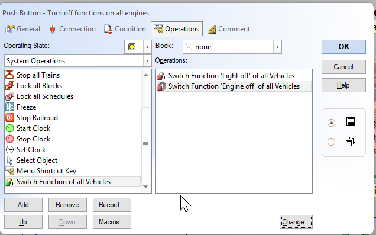

@Garben:
here's a picture of how to use the operation.
In this example, by pressing the button, the 2 operations will be executed on all engines active on the layout.
Try it, Peder
Offline garben
#15 Posted : 18 November 2025 21:07:47(UTC)
garben
Joined: 23/01/2013(UTC)
Posts: 177
Location: New York
Originally Posted by: pederbc Go to Quoted Post
@Kiko: I think we have different ways of using functions, and will leave that discussion now.
@Garben:

Offline garben
#16 Posted : 18 November 2025 23:25:07(UTC)
garben
Posts: 177
Location: New York
@Garben:
Try it, Peder
Found it and works great. Picture worth 1000 words. Thanks again, appreciate it.
