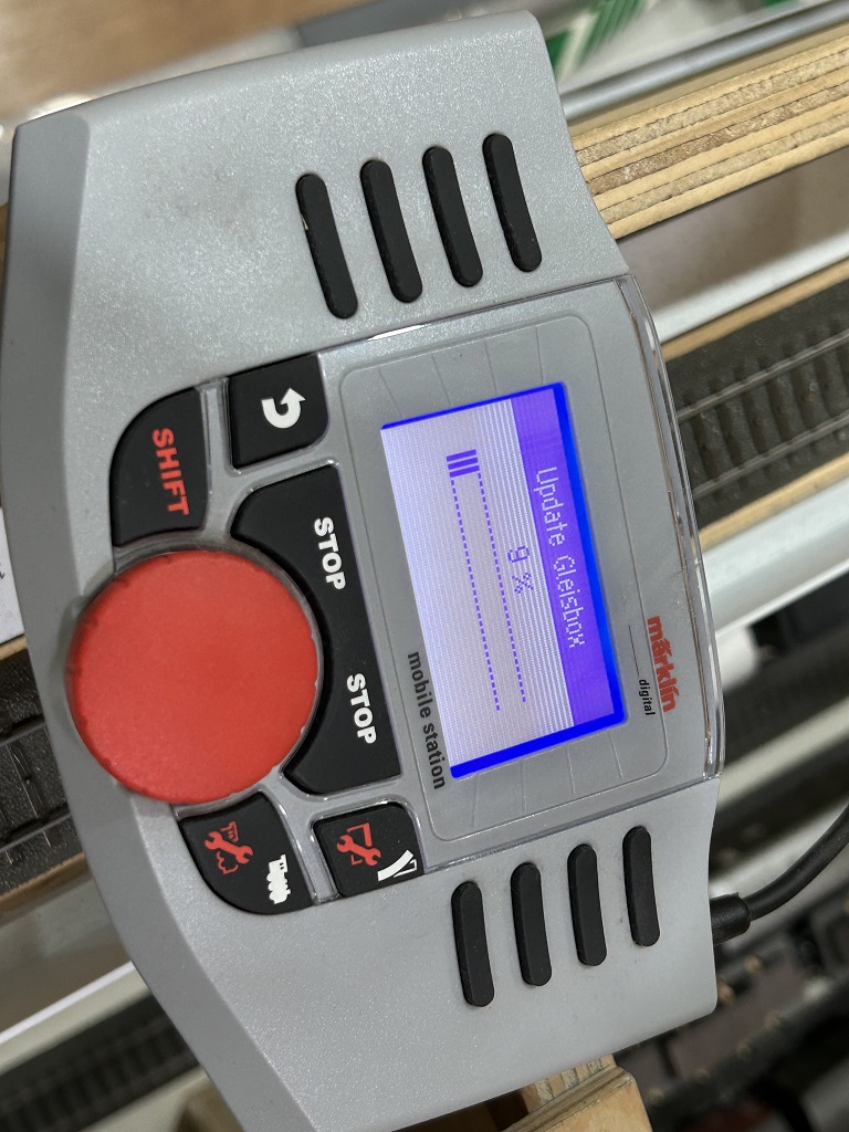

Offline applor
#5 Posted : 24 October 2025 07:01:13(UTC)
applor
Joined: 21/05/2004(UTC)
Posts: 1,810
The pins must be fine because its the exact same cabling as used with my CS2, which works OK.
After yesterdays updates via CS2, I connected the trackbox again and this time it asked me to update.
Great sign!
However after pressing yes it jumped to 9% progress and has not changed for an hour.
I dare say there is no way out of this.
Offline clapcott
#6 Posted : 24 October 2025 09:49:56(UTC)
clapcott
Joined: 12/12/2005(UTC)
Posts: 2,462
This statement is incorrect/incomplete. Although it may not be related to your main problem
There are two pairs of power pins that Maerklin have used in a manner that allows a MS2 to work off both a CS2 and MS2 (Native and with a 60122 HUB). The 60122 MS II Hub will (with its 10 pin plug) will physically plug into a CS2, but will not operate.
The symptom of lights on (power) but no one home (brains) is most likely to be one of the CAN bus pins being bent.
Given that you have indicated there are some brains, because you indicate "...this time it asked me to update...." there still leaves a possibility that the pins are bent such that the connection is not good and may loose contact with movement.
Offline applor
#7 Posted : 24 October 2025 12:52:34(UTC)
applor
Posts: 1,810
If one of the CAN pins was bent, I wouldn't be able to use or update the MS2 when it is connected to the CS2. Unless I am mis-understanding something?

Offline applor
#9 Posted : 25 October 2025 04:36:36(UTC)
applor
Posts: 1,810
It appears that you are unable to update the MS2. A bent or missing pin on the cable would be easy to ascertain with a visible inspection.
No you didn't read my posts properly. The MS2 has been updated by the CS2 without issue. It was only stuck with the 9% when the MS2 tried to update the 60113 trackbox.
And as already explained, I am using the exact same cable/connectors as the CS2 to MS2 as the Trackbox to MS2, so its not a cabling issue. The CS2 and trackbox have the same 10 pn DIN connector socket, I am simply swapping from one box to the other.

Offline applor
#12 Posted : 11 December 2025 10:35:12(UTC)
applor
Posts: 1,810
I received my new track box today.
It immediately upgraded to latest version no problems, booted OK and registered MFX loks OK.
So just confirming the old one was indeed faulty as I suspected.
