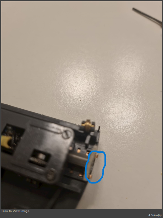

I have a old turntable 8998 and the contactsprings are worn out. I cant find the part or come up with another solution

E243811 is a known issue with these turntable. its the contact spring that connects with each track as the table moves around. Many marklin dealers list the part as available so I tried to order a few places. Maybe they have access to parts that are not available on marklin site. If thats not possible I will fabricate my own solution to this problem. I`l keep you updated

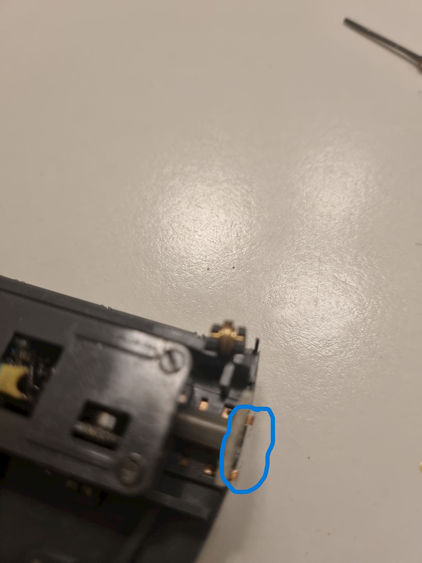

Thanks for the help last night I was able to straighten and repair the contact spring and the turntable is no working like new. I also had to change the rectifier in the controller.
