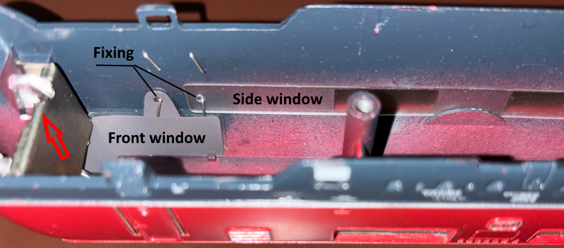

I found this on ebay Germany This is NOT an original Märklin window
https://www.ebay.de/itm/39662433...D%7Ctkp%3ABk9SR5Dkvaa5Zg
Another solution would be to use a transparent PVC sheet (e.g.: format A4, 0.2 mm thick and cut it to the dimensions of the old one.
To obtain the exact aspect of a Märklin Cellon window, you need to install behind a tracing paper for frosted effect. Alternately, you may paint the rear side of the window in middle grey
Fixing is made by unbending one of the front handles on the top and then bend back after installation
Here is how it looks on my 3021 (1965) when it was factory fresh
You will need to slide the sheet metal cover (red arrow) to remove the light conduit and access to the full window
