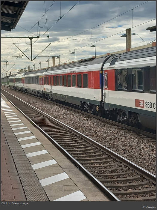

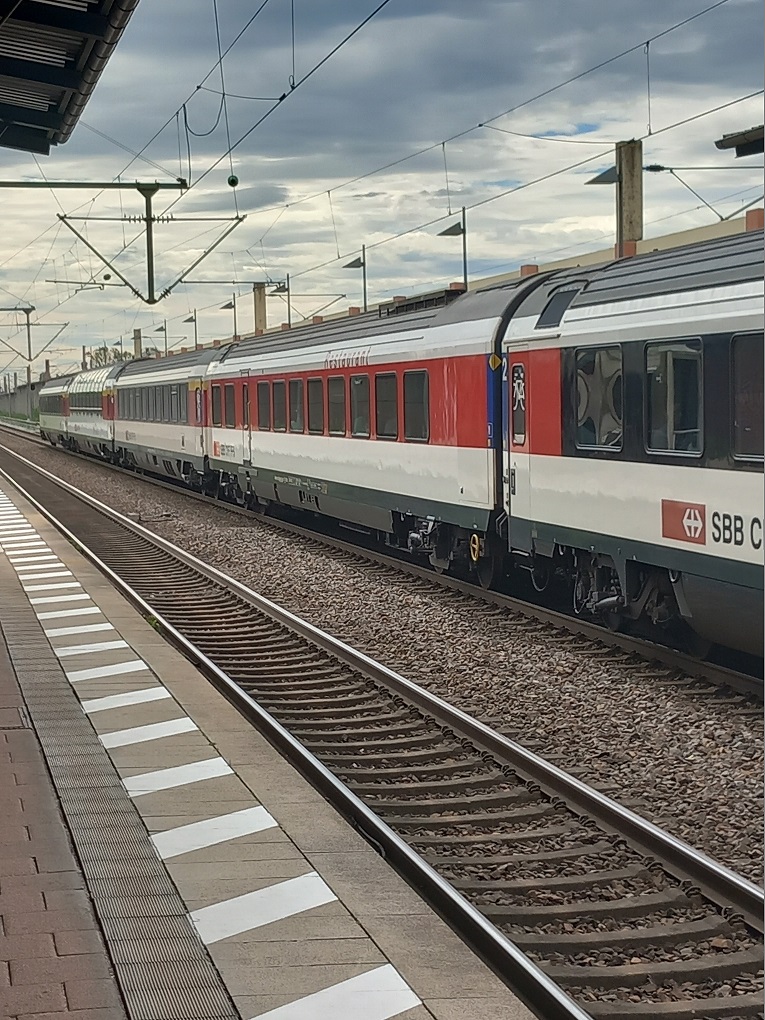

This was a Swiss EC I saw in Baden Baden in 2023 (I think it was heading to Hamburg). Formation included Ist class dome car and a restaurant car.
Carim

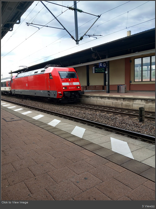

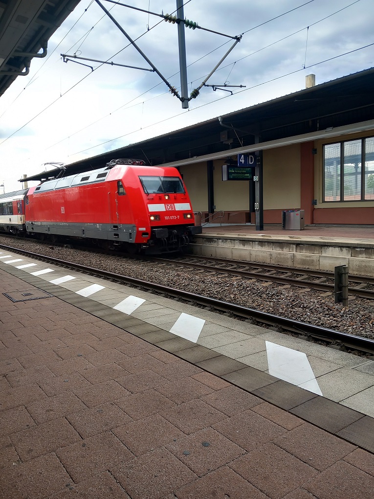

Looking at the destination board, it was going to Hamburg-Altona:
Carim
