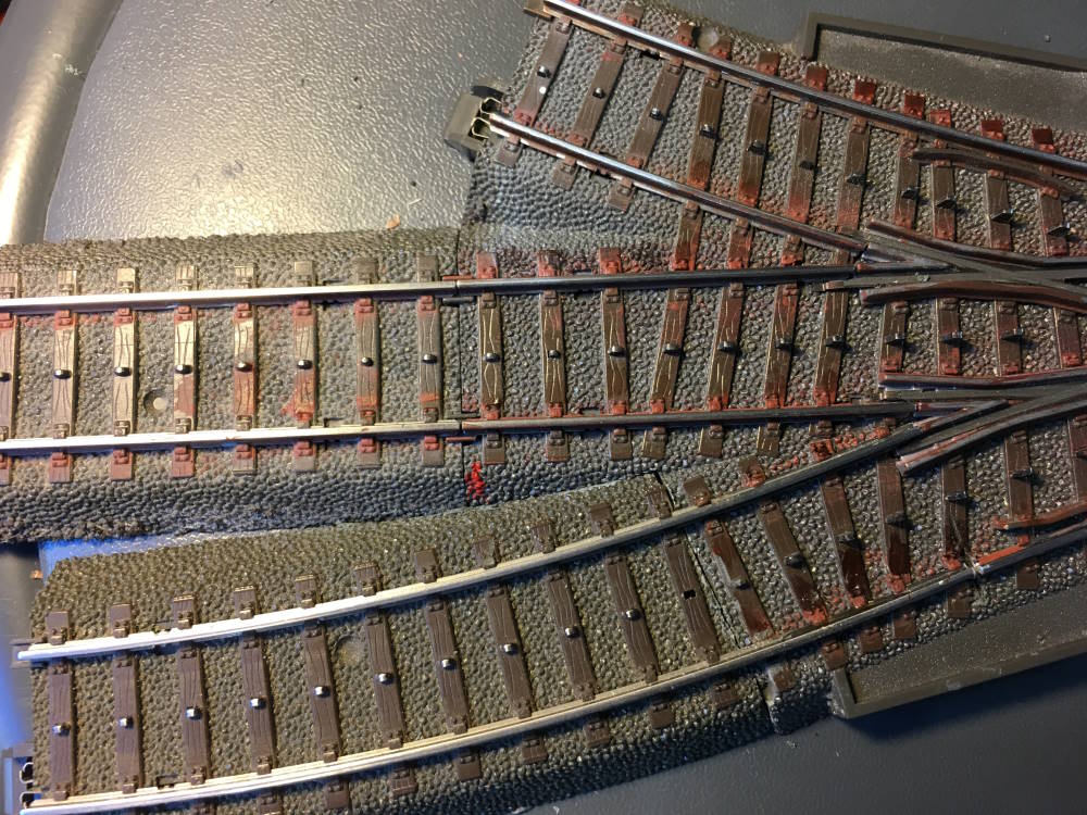

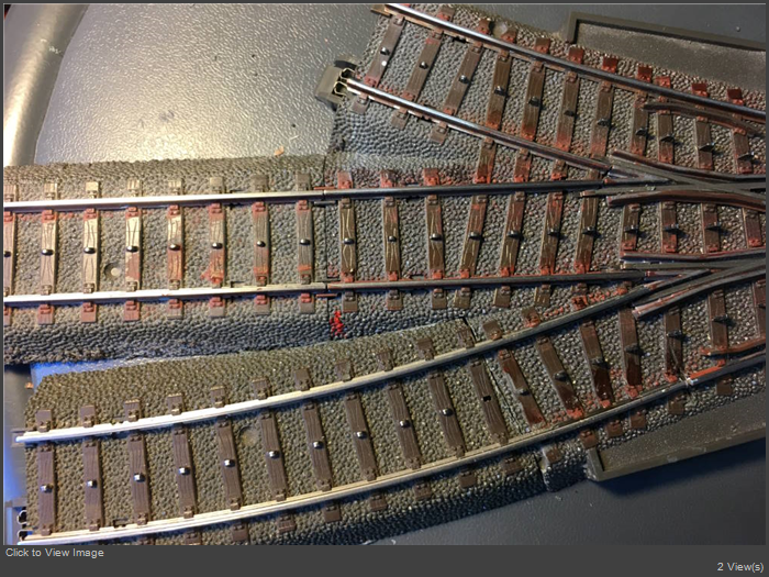

Here is a sample of track surgery I made on a C-Track triple switch
In fact doing this surgery allows you to create ANY track piece you need with "normal" extremities (the C-Track end in my case.
