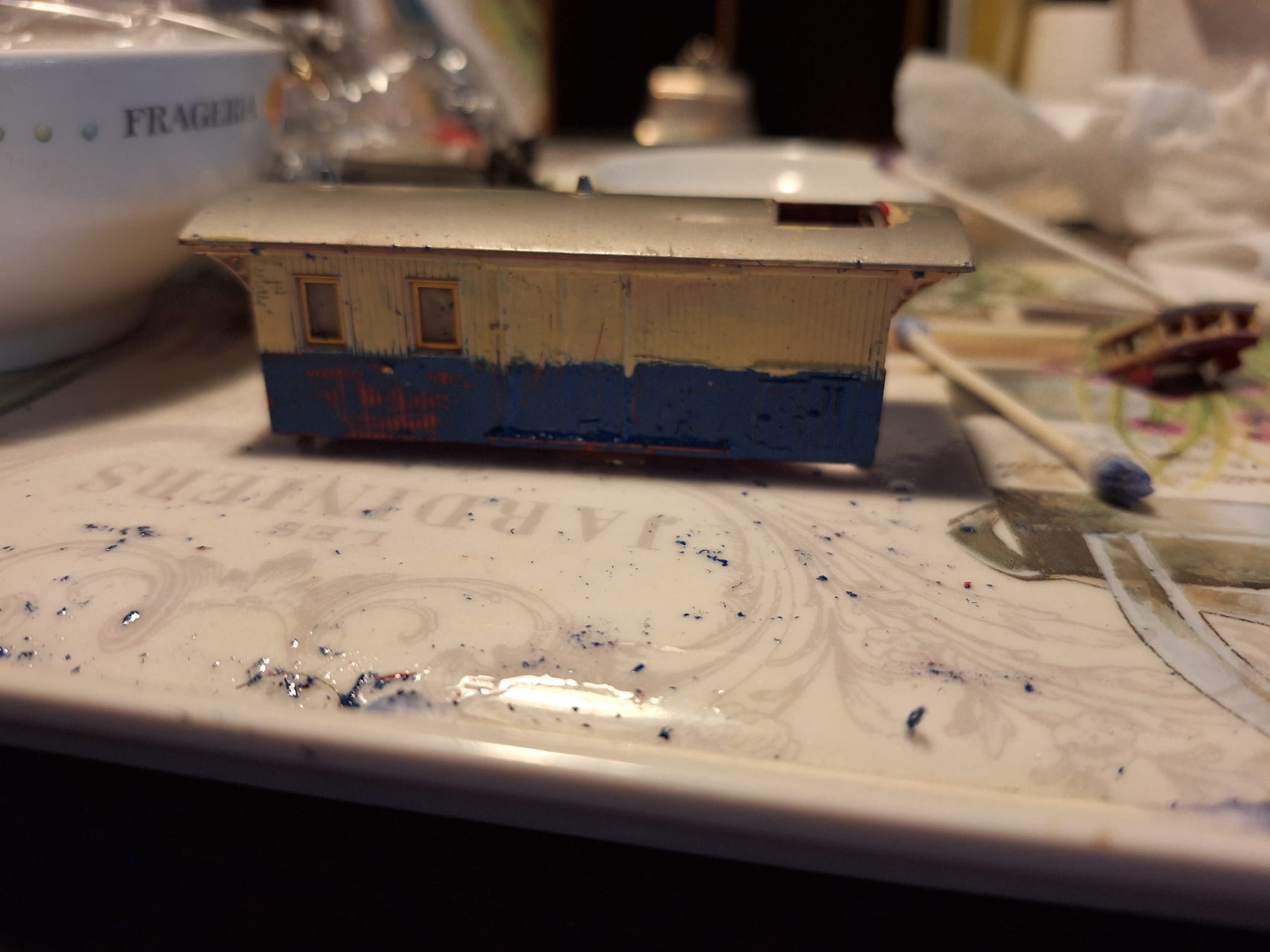

Hello Everyone,
My grandpa had this wagon but choose to paint it.
The paintjob looked quite bad and now I am trying to restore the wagon.
Anyone tips for removing the paint, I try to use white spirit and a sharp scraper which works a bit.
The white spirit isnt doing alot, I believe it is Revell paint he used.
Anyone an idea if there might be something else to help solve the paint?
#2 Posted : 23 August 2025 02:38:53(UTC)
Posts: 4,020
You have to be careful, any solvent that will soften and remove the paint may also damage the plastic. Going to be trial and error I think
Offline mvd71
#3 Posted : 23 August 2025 09:05:28(UTC)
mvd71
Posts: 1,962
Location: Auckland,
I tried oven cleaner on the recommendation of a very experienced model builder. It did lift the paint, but and factory paint underneath can also ne affected if it is on for too long.
Offline Ausipeet
#4 Posted : 23 August 2025 10:52:01(UTC)
Ausipeet
Joined: 04/06/2012(UTC)
Posts: 326
Location: Adelaide
could try nailvarnish remover with q tips and be very gentle

Offline Carim
#5 Posted : 23 August 2025 11:09:32(UTC)
Carim
Joined: 15/09/2014(UTC)
Posts: 695
Location: London
A commercial product that I have used is Deluxe Materials' "Strip Magic". I used it to strip Märklin coaches down to the plastic base. You use isopropyl alcohol to neutralise it, so if you are careful, you can use it to just strip off a top layer of paint.

#6 Posted : 23 August 2025 15:09:31(UTC)
Posts: 4,053
Or a citrus based product.
Offline nagstar
#7 Posted : 25 August 2025 21:45:09(UTC)
nagstar
Joined: 24/04/2025(UTC)
Posts: 5
Location: Utrecht, Amersfoort
Currently trying nailpollish remover which works, slow but steady

Offline Br502362
#8 Posted : 26 August 2025 08:57:12(UTC)
Br502362
Joined: 05/03/2014(UTC)
Posts: 711
Location: Finland
Car brake fluid dot 3 or 4 works well. (not dot 5 which is silicone based).
Dip the plastic part (not clear plastic parts) to fluid and check the situation every hour. Process can take several hours.
Cleaning with hand warm water and a soft brush.

Offline 1borna
#9 Posted : 31 August 2025 21:16:24(UTC)
1borna
Croatia
Joined: 21/12/2012(UTC)
Posts: 1,542
Location: Hrvatska
I have been using brake oil for at least 50 years. I completely submerge smaller models in a container and apply larger ones with a brush. After the paint dries, I brush it off and then rinse the model thoroughly with warm water.
It is recommended to use thin rubber gloves, but you can do without them if you wash your hands thoroughly immediately after work.
Type 3 or 4 brake oil will not damage plastic or metal
