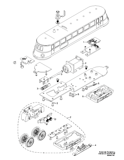

The directionchange lever is a replica without any fonction. It is mobile but does not do anything.
The dfirection change is driven by digital or over voltage or polarity change depending on the programming
