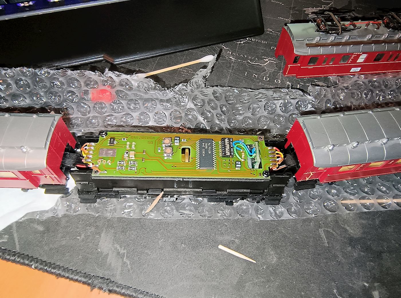

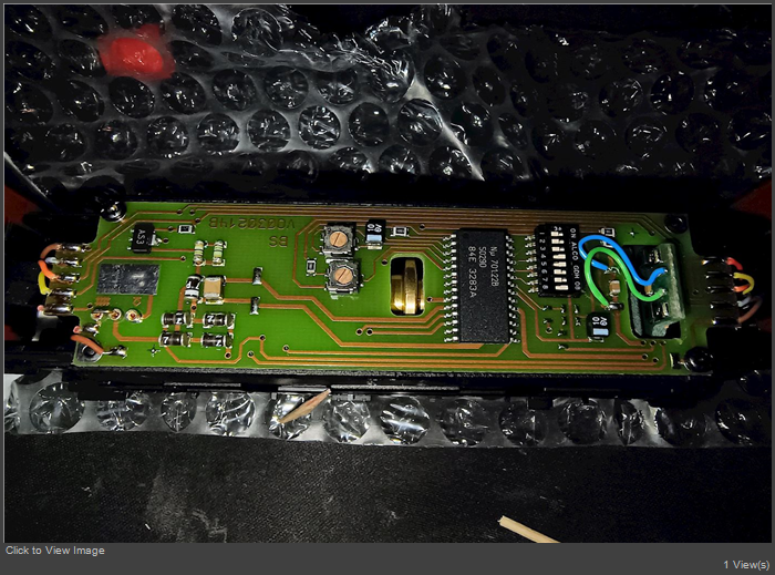

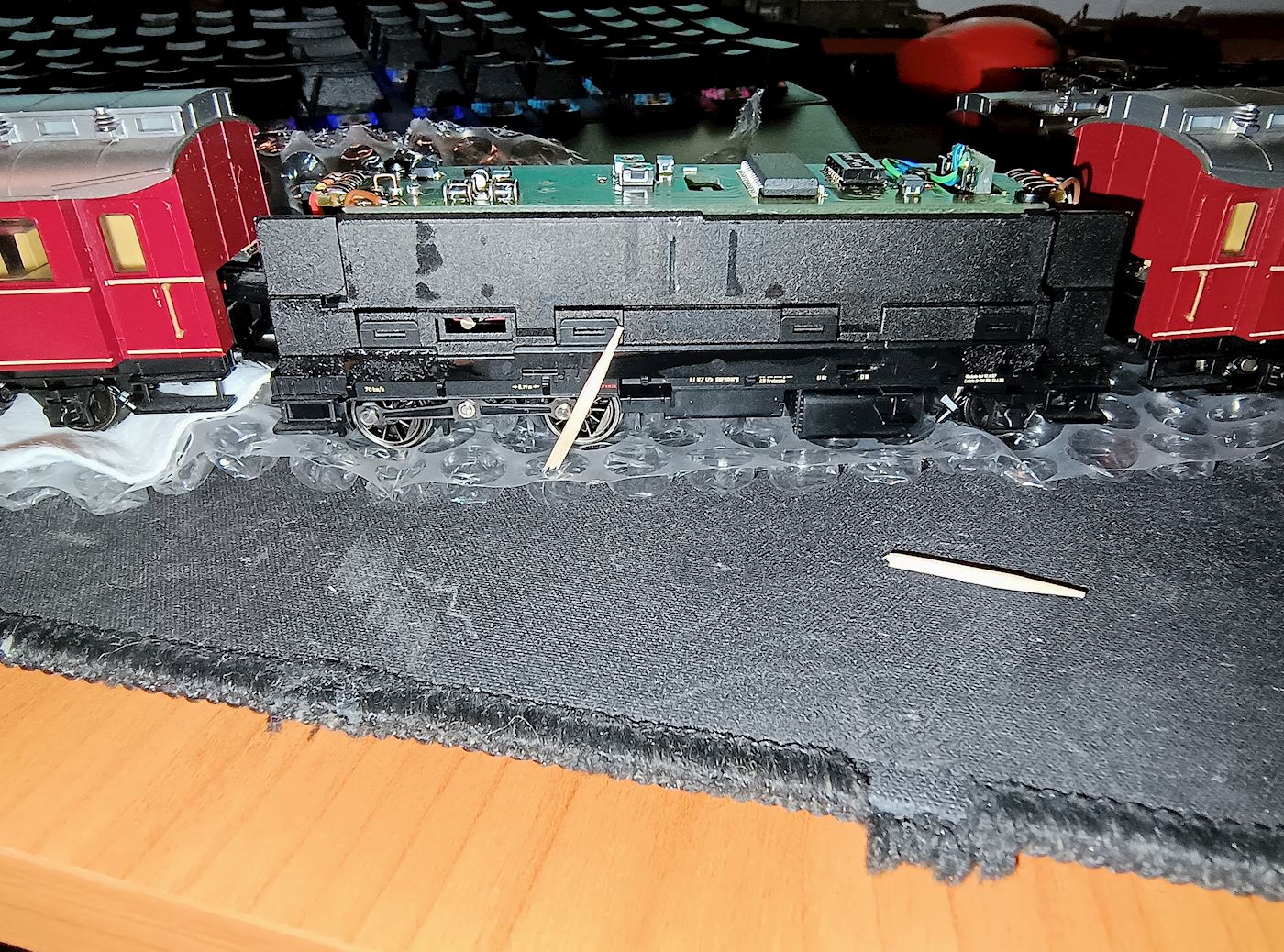

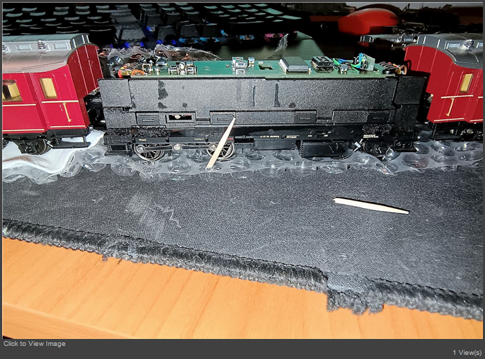

Offline Adrian666
#5 Posted : 06 August 2025 21:29:17(UTC)
Adrian666
Romania
Joined: 06/01/2025(UTC)
Posts: 79
Location: Ilfov, Voluntari
There is probably space enough in the train to add an an additional decoder, i.e. not replace the current decoder. The ESU ”LokSound 5 Fx” function decoder should do the trick. There is a forum thread about this e.g. here:
https://www.marklin-user...-Loco-and-ESU-FX-Decoder
Hi PeFu, i managed tobopen it ip. What do You think , its enough space ?
What package should I purchase in order to add sound effecta ?
IMG_20250806_222428173_AE.jpgIMG_20250806_222437919_AE.jpgIMG_20250806_222433695_HDR_AE.jpg
