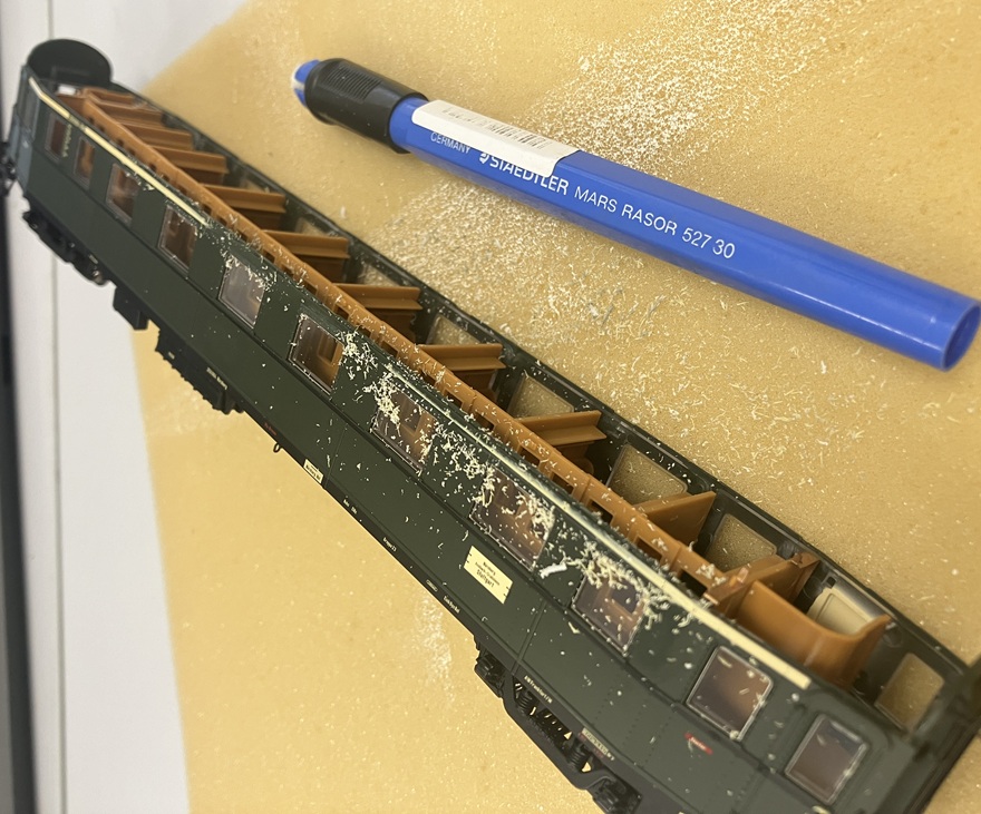

I have modified many dozens of wagons to suit my time period, not only removing labels and replacing with decals but also complete re-sprays etc.
The two gentlest options are: a standard eraser or cotton tip with toothpaste.
Note that regardless it will be removing the outer clear coat, so afterwards you always need to respray the clearcoat.
This is not so easy, because the different manufacturers use different levels of gloss, from nearly flat to almost full gloss and it affects the final colour of the paint.
Therefore I recommend respraying the entire loco/wagon with the same clearcoat so that the final finish and colour representation is the same.
Also note that even with these two gentle methods, it can affect the paint colour undernearth as well - it all depends how thickly the paint was applied.
Some manufacturers you can remove the labels and after the clearcoat it comes up just fine, others (such as Marklin) I have found the colour where the label is will be lightened.
In that case, you must either accept it as it is, or go through the process of paint matching and re-spraying, which I have also done (painfully) many times.
Any more questions let me know but that is pretty much what needs doing.
Oh and also be sure to set your decals (ie. microset and microsol) to ensure solid adhesion because they can come off afterwards surprisingly easy (ie sticky tape) even with clearcoat over the top.
thanks 3 users liked this useful post by applor

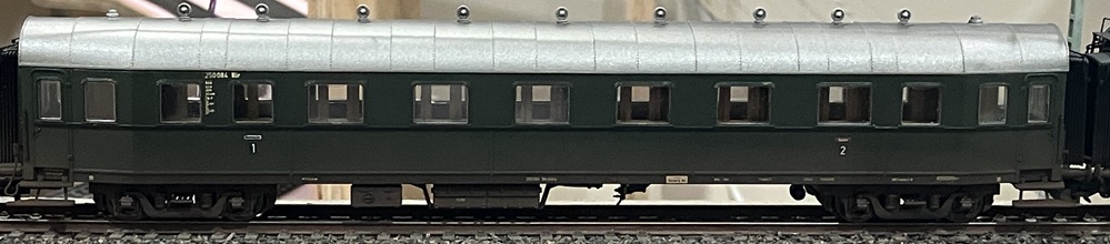

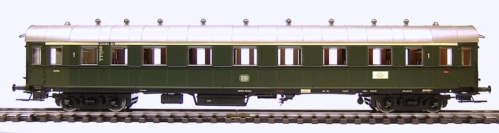

Just as an example here is the Brawa 45300 Polish Pike being converted from EpIIIb (A4ü-30/52) to EpIIIa (AB4ü-30/52).
The difficulty with this one was the removal of the first class stripe, otherwise just class change from 1st to 1st/2nd.
I used the eraser to remove the vast majority of the stripe, however due to the annoying rivets I had to carefully use a toothpick dipped in isopropyl to get it all off.
I believe the DB came off without affecting the paint underneath which would have required a respray (either touch up or full body).

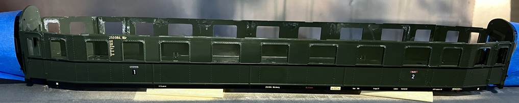

And then after removing class numbers and applying the new decals, the windows etc. all had to be removed for the complete re-spray of the clear coat.

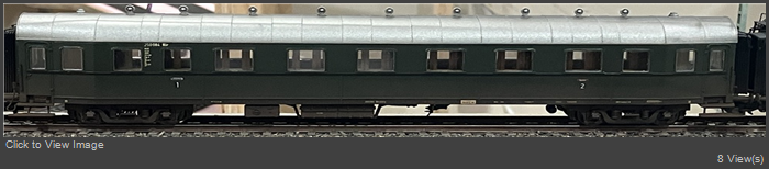

And here we have the final before and after photos.

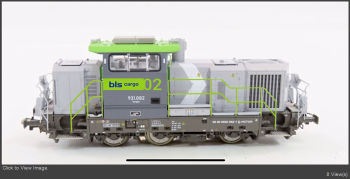

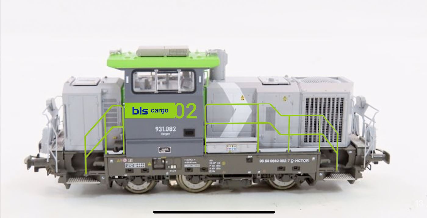

I have to admit for a first time effort my project might be a bit ambitious. So will try with some smaller older rolling stock first. But the goal is to rebrand this Piko G6, from Hectorrail to a fictitious BLS Cargo livery.
This is a bit unorthodox, but hopefully no one takes offense. BigGrin

I gave it a try with the eraser, since it was readily available and avoided any chemicals. And happy to report, that with some patience and effort it worked great. IMG_7963.jpeg
Mocked up color match for new logo.
