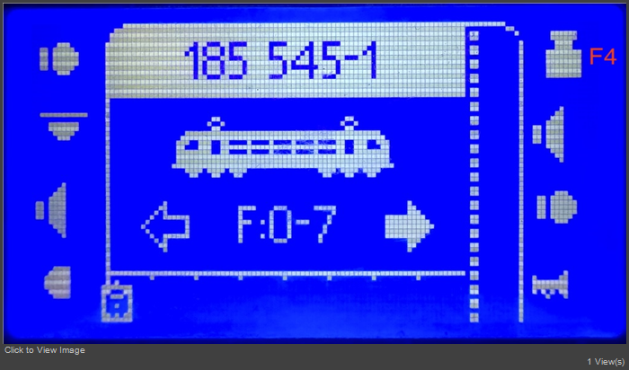

No i mean functions icon and further changed after upgraded.
Here's what I see on my 4.28 unit after reading a 11147 (Minitrix) card:
I'm pretty sure that F4 was a turtle before, when I read the card on version 4.1 (after creating a dummy entry in the first loco slot so that the card would read at all).
Also, on the second screen:
I believe that F15 had a symbol (likely a speaker) as I remember that all functions had a symbol. I'm not sure if there were other changes (loco has 29 functions), these two I remember for sure.
Here are all symbols available in 4.28 under Change Loco Functions:
A little crude and limited set for sure, but it's great to have symbols instead of F numbers only. Anybody knows what the ↕️↔️↪️ arrows are supposed to mean?
thanks 1 user liked this useful post by Kriegslok
#39 Posted : 22 June 2025 13:29:51(UTC)
Posts: 8,717
They look like they are for use with the digital crane, like the 46715 and later. Load up/down, jib up/don and rotate. The first one may also be used when a loco has pantographs that can be remotely raised and lowered, although I think the correct symbol for that function is the first symbol in the last picture.
Thanks, I didn't think of cranes... but in that case one would want to rotate both ways?
FWIW, this is a screenshot from the MS2 manual, it looks like the symbol list has changed and the "weight" (or whatever that is) has been added after the smoke, and the turtle etc. is shifted by one position:
I also found an older MS2 video where the entire list was shown, here's the end of the list, looks like nothing was lost, only one symbol added.
It seems to be affecting some icons in saved configs.

#41 Posted : 22 June 2025 23:46:19(UTC)
Posts: 8,717
That is because of the way the cranes work. You select the operation you want to do, then turn the speed knob the appropriate way to go at the speed you want. Turn the knob the other way and the reverse operation happens. Same for all three operations (note that up and down are not two symbols, and jib up and down are not two symbols).
Gotcha - they actually mean this: Laugh
