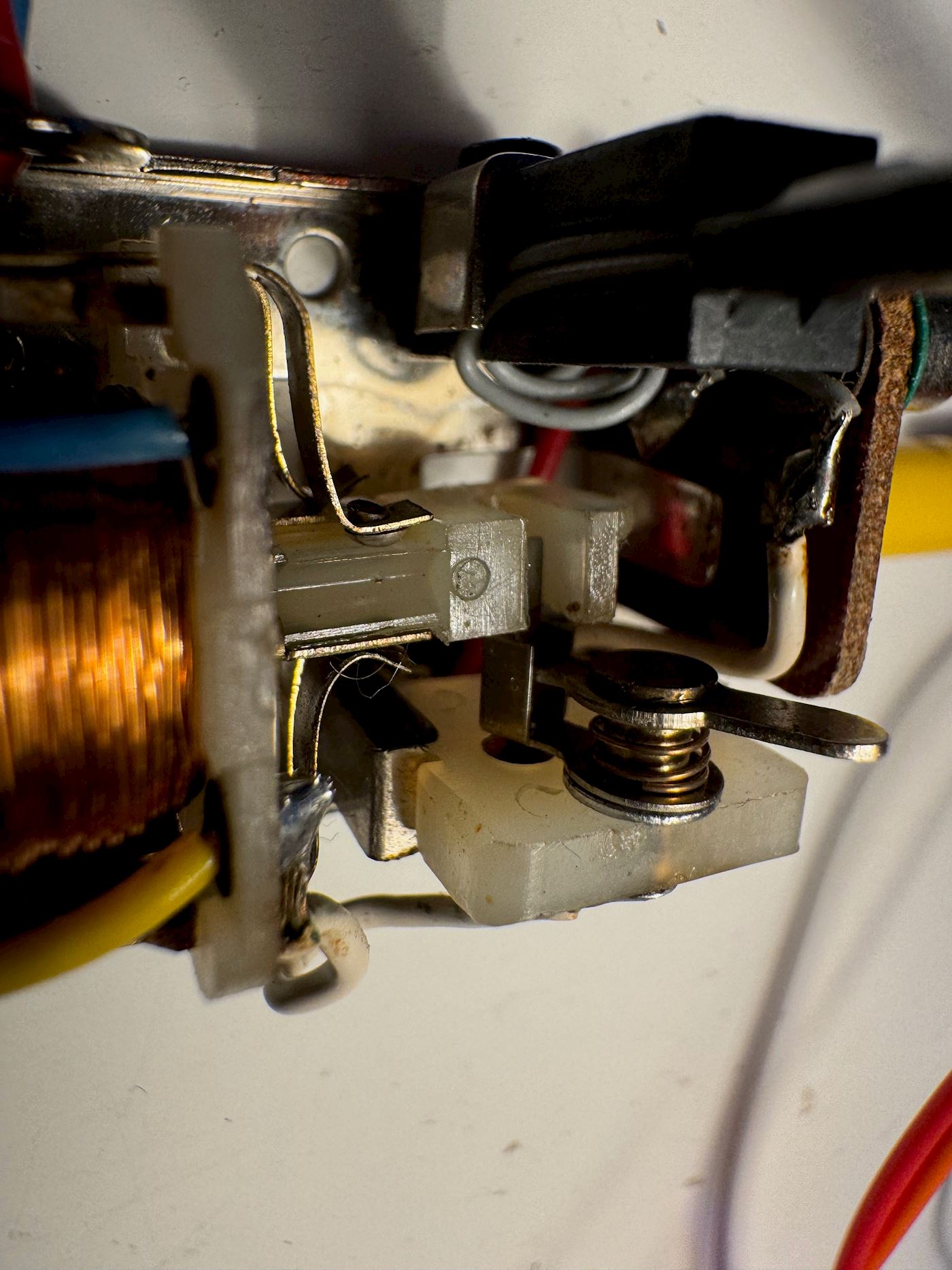

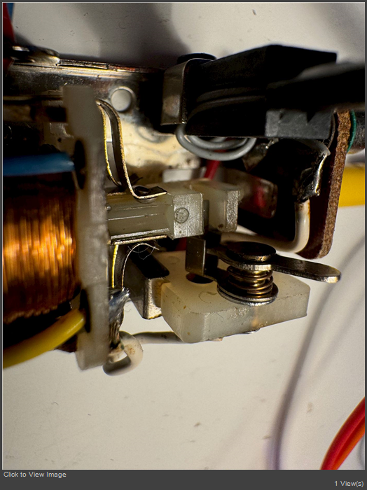

Two steps forward and one step back with the signal.
I've taken out the solenoid and cleaned the inside of the tube and also the slider.
My problem is that the slider is only going about half way either from the 'red' to the green or the other way around. (To be clear, if the slider starts on the 'red' side and the 'green' wire is energised then it travels half way to the green side and stops. If the 'red' wire is then energised the slider moves all the way back to the 'red' position. If I start in the 'green' side then energising the 'red' wire moves half way and then energising the 'green' wire the slider moves all the way back to the 'green' position.)
There is a lever that is moved by the slider that also connects the power to the red and green bulbs - see photo:
If I move that lever out of the way then the slider travels the full distance but with the lever in place the travel is restricted.
I've read that products such as WD40 are bad for these parts, and also I've not yet bought the contact cleaner suggested by @xxup, so I'm looking for suggestions about 'safe' ways to free up the movement of the lever?
Susan
thanks 1 user liked this useful post by Aussie Susan
Offline Michael4
#13 Posted : 20 June 2025 09:26:51(UTC)
Michael4
Joined: 02/02/2017(UTC)
Posts: 695
I'm a believer in lighter fluid and plenty of exercise.
I've had signals where that lever impedes the travel of the shaft. Lubrication may not help much. In one case the lever itself was slightly bent which made it too stiff to travel smoothly. In another the mounting of the lever was slightly bent which made it jam when half way.
It is a fiddly thing that seems to work best when the motion is sloppier than you think it should be!

"If I move that lever out of the way then the slider travels the full distance but with the lever in place the travel is restricted." So the double solenoid is good. Congrats!
As a temporary "fix you could put a small drop of oil on the axle of the lever, work it a while, and then see if the slider travels full length with the lever engaged. That would at least show if the lever is aligned correctly. Then when you get a contact cleaner you can clean all the old gunk and the new lubricant out of the lever's axle and it "should" work like new.
If the oil didn't help, then carefully looking for ways to realign the lever might work.

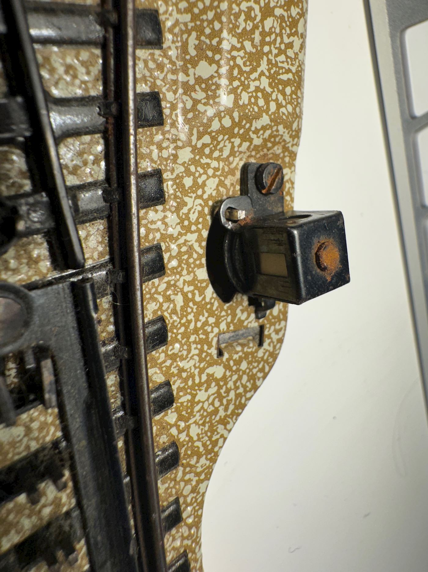

OK - The current situation is that the signal (7188) is now working well so I think I have enough understanding for the others - you'll hear back from me if this is not the case.
Therefore I've moved on to the points (5202). With the one I'm dealing with now, the solenoid itself is moving freely and the issue seems to be with the 'knob' that allows for the manual setting onf the point. (see image)
If I take this off then everything works but with the knob in place, it gets stuck going one way (the other way works).
Therefore the question is: is there anything I should NOT use to try to free up the movement at the top of the knob?
I was thinking of graphite powder or WD40 but I'm open to suggestions.

Looks like you got the "lantern" on wrong. You gotta hook the little finger (opposite the screw side) into the square hole. Then, bring it down and pick up the solonoid rod. Then, put the screw. All this whilst keeping the bulb in the lantern assy. If it goes on real easy, You're probably doin' it wrong.BigGrin
USE NO OIL

I would certainly use a minimum amount of WD40 on the rusty pivot at the top of the lantern, and work it back and forth to work the rust out. Maybe give it a wash with some isopropyl alcohol afterwards to remove any excess WD40 and rust 'grains'. Oncew the lantern will rotate easily then reassemble onto the point as per Mikeys instructions.

@analogmike - thanks for pointing out my last assembly mistake. I've corrected it but the problem remains.
Also thanks - 'lantern' is a MUCH better term than 'knob'!
@kiwiAlan - I'll give that a try.
