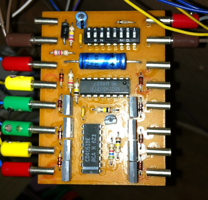

Here is a first version of k83 (1985 till 1995)
So I suggest you check the wiring or a possible damage tp your K83

Ahhh, the 'good-old' Motorola MC145027 chip... bring me back to when I was young and playing with Elektor Edits...
Jean is right - replace the 2 electrolytic capacitor in there (big one for sure) and I'm pretty sure you'll be good as new!
