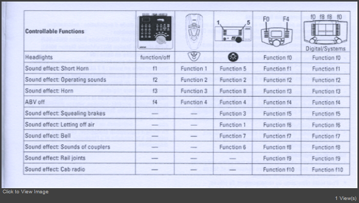

My layout is controlled by a Intellibox II (Uhlenbrock) multiprotocol AC-DCC.
No problem with the DCC locomotives and modern Märklin AC-DCC locomotives.
But I amb observing that with the Märklin locomotives only with motorola format and with more than 4 functions like for example 37628 F7 Kansas City, I enclose the functions manual detail, all funtions described in the manual with function 5/6/7/8/9 and 10 do not work at all. That happens with all Märklin locomotives with this type of decoder motorola with more than 4 functions.
It is normal? What can I do in order to solve this anomaly?
These functions only works with digital Märklin comander?
Thanks for information.
Rgds.
Josep
