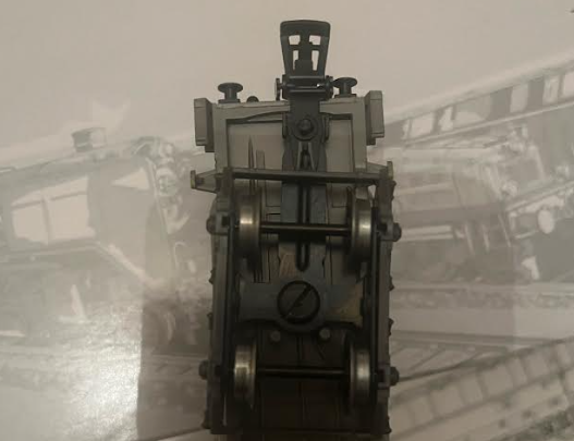

I just recently got a couple of old used märklin cars with what I assume is interior lighting. This made me wonder if I could use them with the light feature on my digital system? I know the article number of a few of the cars. The article numbers are 4027, 4023 and 4032 and they all have the "regular" märklin pickup below the car. One of the cars i got is missing the box so I dont know the article number of that one and it has a slightly different pickup. I will provide a picture of the pickups of that car.
Many thanks

Location: USA
Lights will work on track power, incl digital AC. Slider is old type and needs exact positioning to avoid shorts that may reset digital control, especially over switches.
Ben
Ben
Thanks for the reply! Would you say that it is better to use the cars without the slider? The other cars that I mentioned, but did not provide pictures of, all have the "regular/modern" slider. I assume that they dont have that problem?
Offline BenP
#4 Posted : 21 April 2025 17:29:08(UTC)
BenP
Joined: 04/02/2021(UTC)
Posts: 564
Location: USA
Ben
Both work, but short one may flicker lights more. Longer one between wheels is better positioned and has more contact. Just see what works; won't damage things.
Ben
Ben van der Pluijm--
#5 Posted : 21 April 2025 20:25:36(UTC)
Posts: 15,578
Consider replacing the light bulbs.
The type for analogue operation is typically rated 60 mA at 19 V, the type for digital operation typically has 20 mA at 22 V.
Analogue light bulbs can become very hot with digital operation and maybe even damage plastic parts.
Thanks for the tips! I will certainly try to change the bulbs then. Do you know any good place where you could buy those kinds of bulbs cheap in Europe?

The coupling looks like this: b2dd4ea2c7c15586876c52172580921f.png It looks like it would be quite difficult to replace it, but I have no clue.

Yeah, the ones in the link may work, but it’s hard to say. Those ones are held on with a retaking ring on what looks like a metal bogie. Might take a customised solution.
