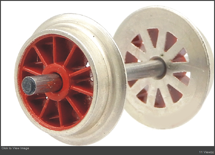

Hi Marklin Enthusiasts, I was given a 44 066 G800 Steamer that had been in a storage locker for an eternity. With initial inspection other than a few paint chips and 2 bent rear Wheel sets on the Tender, it looks great and stored in it's original wood box. After carefully cleaning, oiling & lubing and using my AC Lionel 1033 Transformer....she runs great. But now I am collecting some M track straight & curved(as I have 2 straight sections that came with the Locomotive) Marklin Transformer and some freight cars. I need to replace the Axles which are just mangled(must have been dropped bad) with new ones while keeping the red rimmed wheels which are in terrific shape. Any help with ordering said axles would be greatly appreciated and Thanks!! IMG_20250118_100905242.jpg

What a fun way to start a Märklin collection
I would try to buy these 00.254.5.3
They look like this
They are 10€ per wheel set.
The shop is TTN Internetshop
https://ttn-shop.com/ersatzteilliste_f800.php#1059
They look like this

Thanks JohnjeanB Saved the G800 Marklin Parts to my Favorites and greatly appreciated. Wow that 1951 Issue is incredible and looks immaculate. My friend who gave me this loco said his uncle served in the Army in Germany and this was all that was left of his collection and had been in storage for a very long time. My only question is how those Tender Axles got bent as the unit is incredibly built...did someone take a hammer to itLaugh Laugh Anyway Thank you and I'll update as I progress!
