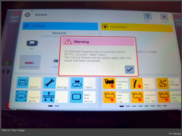

Did you just do a software update? The early Version 2.5.2 caused problems though most often with the booster update (this happened to me). There is a new version on the Marklin website that is supposed to fix the issue but I haven't been willing to try it until Marklin publishes some information about it.

Hi Adrian,
Roger
Hi Roger,
I did an update 40 days ago, when i bought this station. But 2 weeks ago i tried to update a mobile station using cs3+ but i didnt connect to internet.
This is the second time i get this message

I always create a dated save before updating but if you can't access it not much good.

Originally Posted by: Adrian666 Go to Quoted Post
Hi Roger,
Run this with USB stick
https://streaming.maerklin.de/public-media/cs3/cs3update_v2.52-NH01.25-GFP3.95.btrfs

All I know is that the latest (newest) 2.5.2 update fixes the problems that an earlier 2.5.2 update introduced with boosters. JohnJean made a post about it.

I occasionally get this when a track short occurs (especially with slider). Rerailing a train or wagon makes it go away after red button double press (no restart).

I get the feeling that CS3 itself short-circuits during startup and after being activated from Stop mode.
Could there be any improvement needed for 12.113?

This has been going on for at least half a year, since the update with the booster downgrade. I understand that Marklin doesn't have it's own software engineering development team and it takes longer to design patches and fix glitches.

I tried the latest update and lost another booster. WTF!
What do You mean by lost another boostere?

Could be a booster that cannot connect with the CS3?
It seems wrong update by Märklin.
Not sure when Märklin will fix the problem soon or if Märklin change the program to older program which did worked better?

The booster shuts down because of high voltage which isn't actually there. It does it under no load within less than a minute when turned on.
