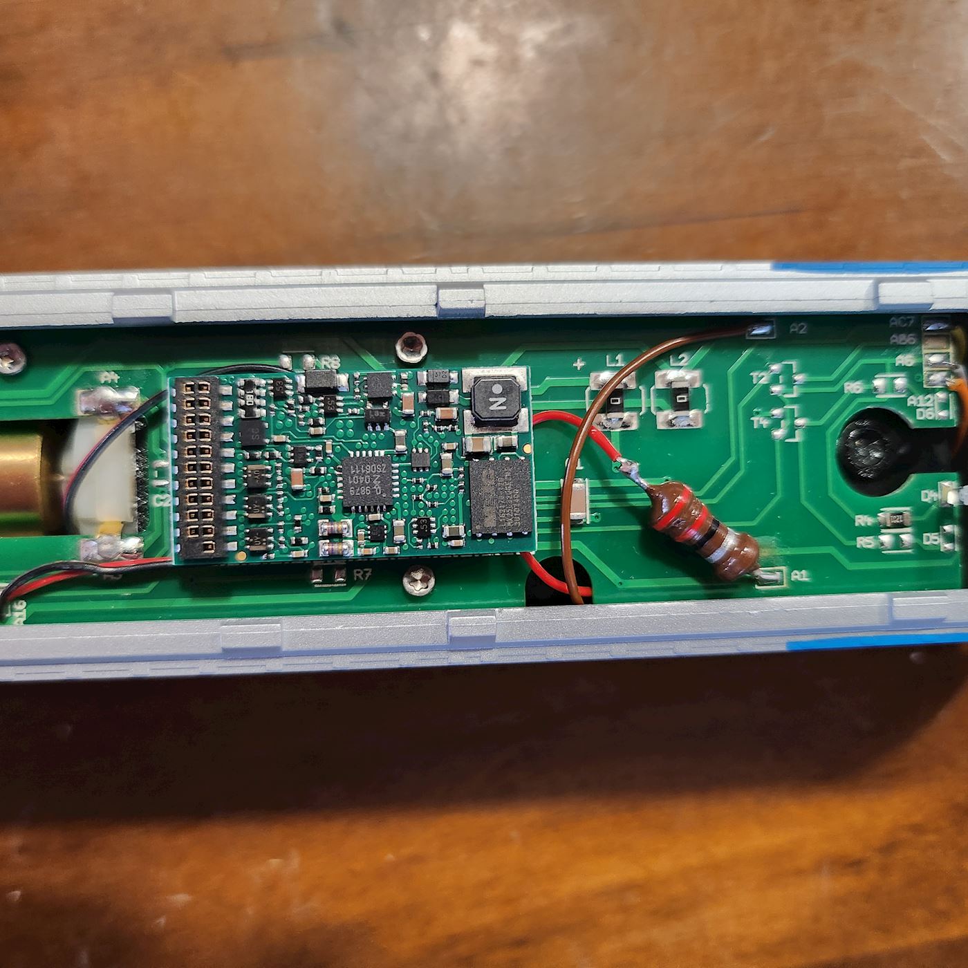

This train is dead can't find any address , i don't know if it is mfx or fx or something els any way no respond at all 20250320_143419.jpg20250321_123059.jpg20250321_123049 (1).jpg20250321_123049.jpg

What are you using for a controller? And what is the running number or Marklin number?

That is the running number. The Marklin model number would be on the box. Do you have a programming track? And have you tried to connect a 9V battery to the slider and an outside wheel to see if the motor runs? Do you know how to do a "Find locomotive"?
Oh, that is the mfx loco 36190. Try missing mfx loco. With the loco on a programming track.

the motor is running but how ever i try to connect to central station it dosent`t find the train ???

Turn off the mfx on your CS3. Then load new loco with DCC address 24. If that does not connect with the 36190 the decoder is fried.
