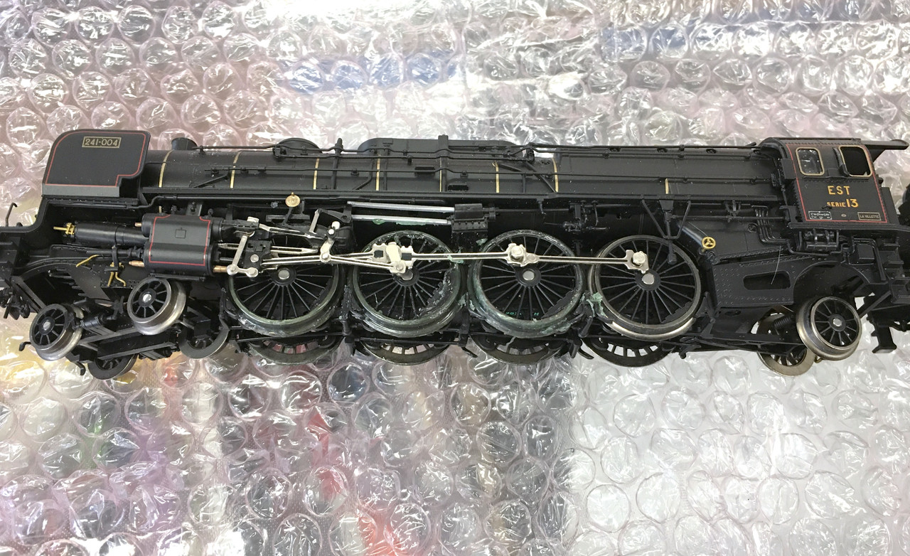

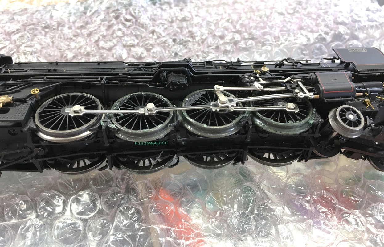

I was at my dealer back in the summer and he showed me a loco (39244) that a customer brought in for service. The customer stated that the loco was having trouble running properly after he applied “adhesive” to the drive wheels (it looked like he applied hot glue?). He did this because he felt there was not enough traction.
Suffice it to say my dealer refused to work on his loco since the problem was “self inflicted”.
It’s hard to imagine what the owner was thinking when he thought that applying “goop” to the drive wheels was a good idea.

Most adhesives are soluble and list the remover in their instructions. That is an expensive loco and worth some effort.

Hot glue softens up again when heated. It needs a good cleaning.

It looks like Silastic - like the rubbery stuff used for gap filling cracks in a wall. I get the logic, but the application needs work. Crying

Regarding the loco that has been smeared with glue (a savage operation by a totally incompetent person) there are 2 possibilities:
- both require the removal of all driving wheel by unscrewing the bottom cover, by removing all the distribution screws AFTER TAKING NOTE OF EACH SCREW PLACEMENT AND THE SPECIFIC WASHERS IN-BETWEEN AND ALSO THE PLACEMENT OF EACH AXLE. CAREFUL WITH SPRINGS AND BEARING PLACEMENT. TAKE A LOT OF PICTURES
- Method ONE: clean the wheels by putting them in the freezer so the glue becomes very hard and is easier to remove
- Methode TWO: order a set of driving wheels (they are NOT normally on sale so contact MärklinShop first (in Germany). Märklin may insist to replace the wheels themselves.
- re-install the wheels in place by placing all the contact finguers, the spring etc.
AVOID DOING THID IF YOU ARE NOT PATIENT, NOT METICULOUS AND IN ABSENCE OF A LARGE AND ILLUMINATED MAGNIFIER
Specific driving wheels. They differ with:
- insulation - or not - of the wheel for the Trix or Märklin version
- painting: Black with white tyres, red, green depending on the model
Note: because all driving wheels have finger contact, insulated wheels may be used for a Märklin 3 rail application BUT CONVERSELY A TRIX SET CANNOT BE USED ON 2 RAILS
The pulling power of this loco is already more than enough for reasonably long trains (10 cars), reasonnable ramps (3% max) and reasonnable rolling resistance (no slider at each car, no ground return except on bearing like in the Eldelweiss set.
Adding an extra layer of adhesive to the wheels is "bricolage" (shitty work on such a splendid model) changes totally the contact forces for each wheel set and in all probability will cause runing issues and possibly also a motor fatigue that may result in destruction
