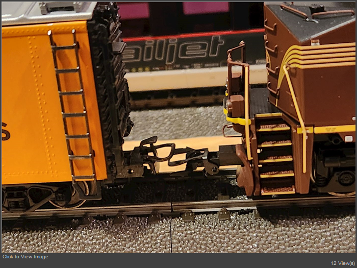

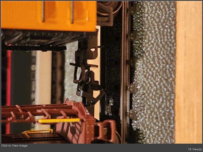

#9 Posted : 18 February 2025 20:11:16(UTC)
Zeeboo04
Joined: 24/07/2022(UTC)
Posts: 25
Location: New York, Saratoga Springs
Maybe we need some photos of your old couplers, because I run 50+ year old materiel whose couplers connect perfectly with Märklin close couplers?!
This is one example with picts. Some of the older cars I have are even more unaligned with the new close couplers then the one in theses pictures. 20250212_151706.jpg20250212_151610.jpg20250212_151710.jpg
thanks 3 users liked this useful post by Zeeboo04
#10 Posted : 20 February 2025 21:26:04(UTC)
Posts: 3,664
Okay, I see what you mean.
I would dare to say that, THAT is a non-problem...
True that there can be small allignment problems. Especially I have found that close-couplers tend to hang a little, thus being lower than the old Relex couplers. As you can´t really adjust the close-couplers and their holders (among other reasons because they are mostly made of plastic...) what you CAN do is adjust (carefully) the old metal couplers.
It might be the case that whay you are looking for is doing switching games and smooth automatic re-coupling. Good luck with that :-)
But if you are looking for a more pragmatic use, then I can assure you that all my trains runs very well with a total mix of Relex and newer short-couplings; The main concern for me being that waggons dont uncouple accidentally anywhere.
